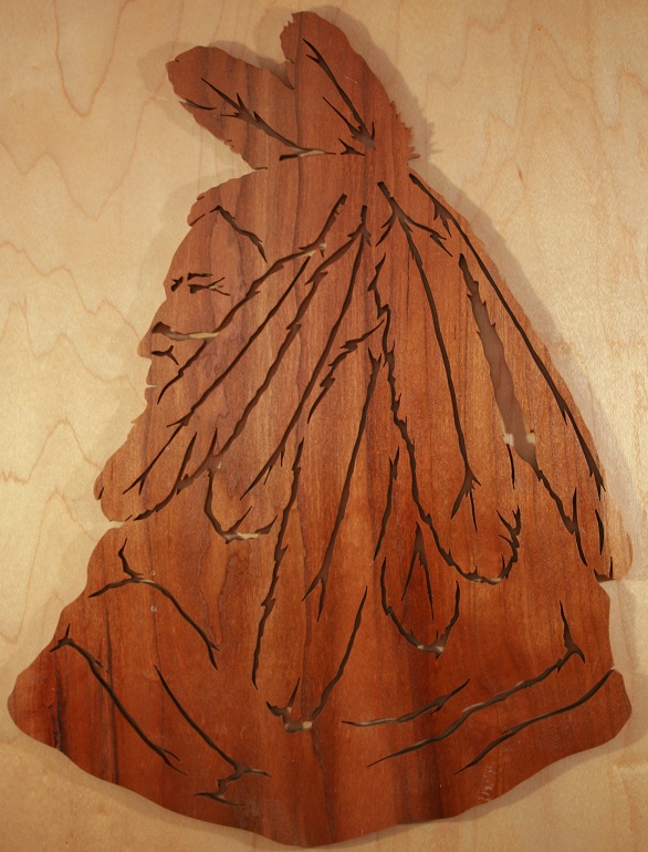

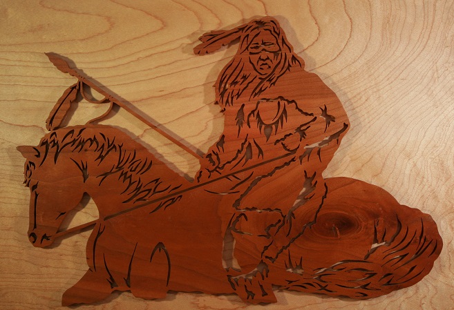

You can BUT its not a production machine. It will be a very slow process. Cutting thicknesses over 3/4" with a scroll saw is very time consuming. Trust me you will not be happy. A band saw or table saw is a much better choice. You are better off using your scroll saw for something like this.
