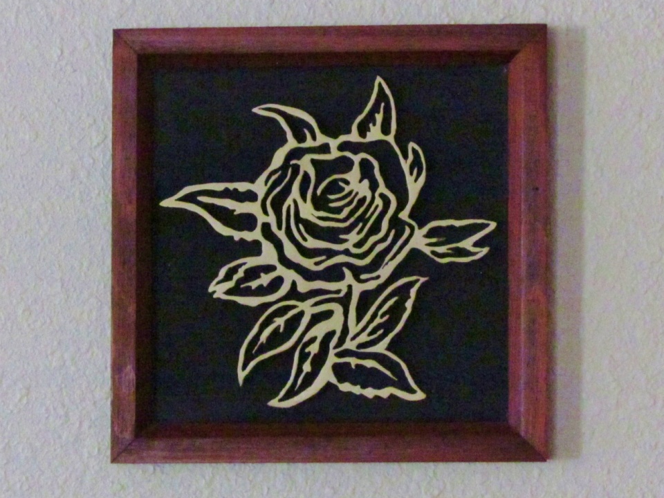

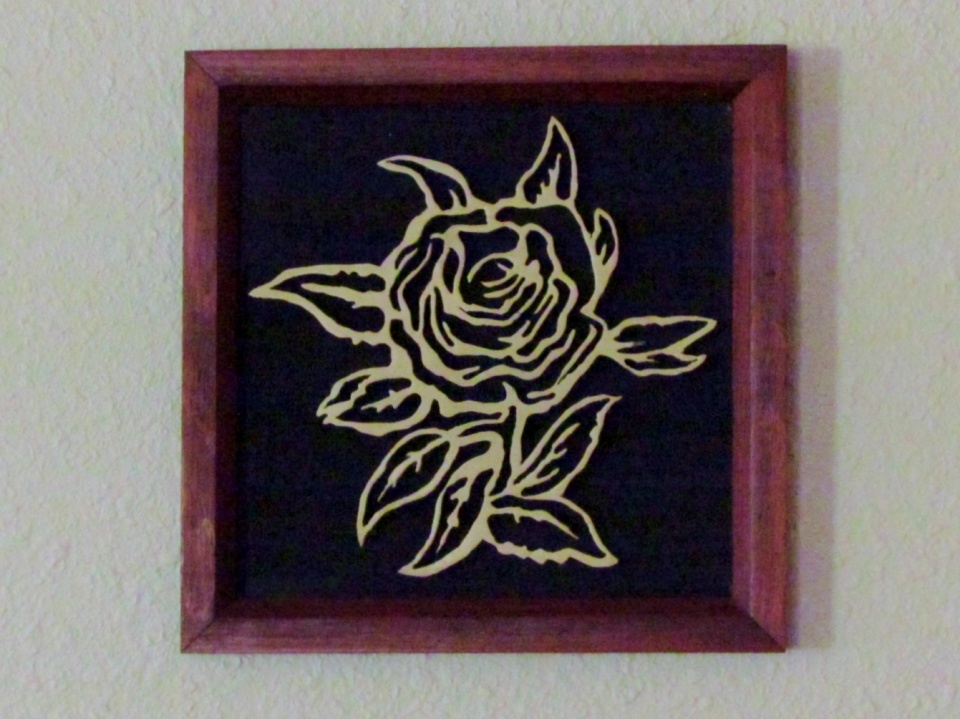

This is a piece I made somewhere between 12 and 15 years ago. This week it ended up back in my shop for some repair because the rose has come unglued from the backer board. I built the frame from pine and stained it. The backer board is just a piece of 1/4 plywood painted flat black. The rose was cut from 1/4" material and glued to the backer board (though maybe not well enough, seeing as it came unglued). Now that it's all one piece again I thought I would snap a few pics and share it. I'm kind of glad it came back because I don't think I have any pics of it from when I originally made it. I know there is at least one other scroller (jttheclockman) that hangs around here that might enjoy this.

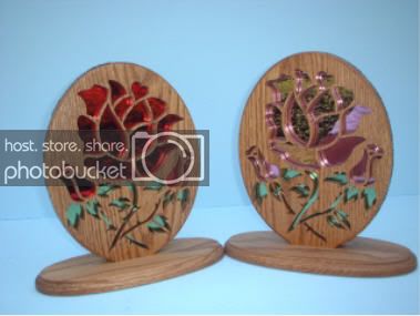

Hello Derek. I did take notice and in fact whenever anyone shows off scroll sawn items I take notice. That is a very nice looking piece of art work. Nice cutting.
Not sure how you glue your overlay items on to the backerboard but a little trick I like to use is take a sponge and cut in small pieces. I put some glue on a piece of wax paper and then dip the sponge in the glue and dab the back of the overlay pieces. I can then glue all areas of the piece without failure. Just need to be careful not to use too much glue that it runs on the sides. What the sponge does is allows air pockets so the glue fills in better. Never had a failure. I also use Titebond II glue. As an example::):)
My entry into the rose picture. Scrolled and backed with red, pink and green mirror.:):)
