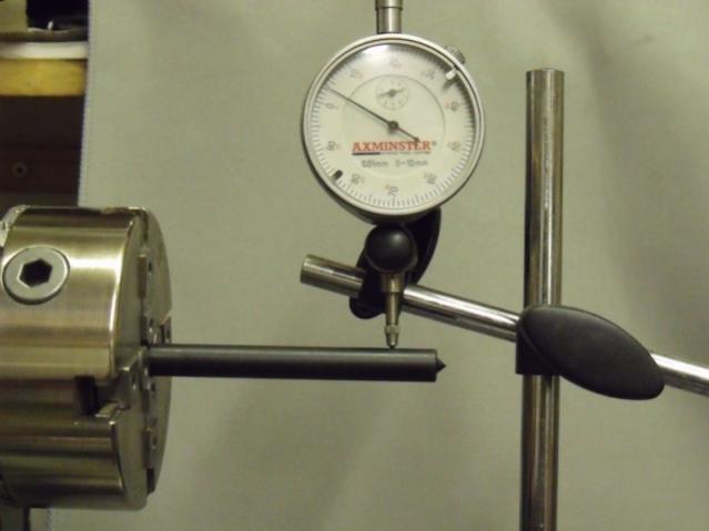

I just did a test.... I removed the jaws and lightly clamped a transfer punch in the chuck just with the jaw holders ( is there a proper name for them? ) I don't have a proper Test Rod
I mounted a dial indicator and was very impressed with the result.
I got a difference of 0.06mm ( 0.002 in ? ) Now that isn't bad by any standards.
Now I replaced the jaws making sure the numbers on them matched.
Mmmm...0.26mm ( 0.010 in ? ) Pretty poor by machine standards and if that was on a metal lathe, I'd be worried.
But lets think about that for a minute. Just how much IS 0.26mm?
And let's not forget that the actual 'out of round' is half that. So how much is 0.13mm? I hunted around to find something that we all are familiar with.....a sheet of paper from my printer. Bang on almost at 0.14mm.

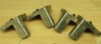

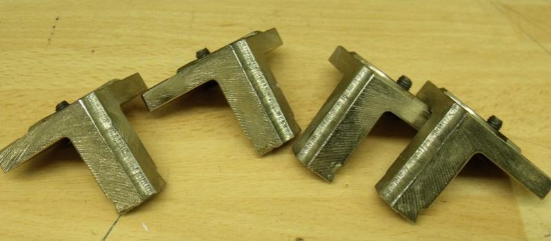

I took a pic of my jaws and I'm sure you will agree that they are not pretty and have had a lot of abuse. :eek: But I will dress them up with a Dremel this weekend for sure. I will use my metal lathe to do this, but there are methods on the web that show you how.

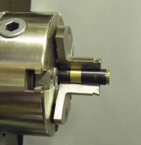

I don't have true pin jaws. I use, what I believe are termed, #1 jaws??
And my shooting semantics are terrible. I hold the brass part that turns into the pen---call it whatever you wish. It spun in the scroll chuck. The collet, positioned immediately below the part I am going to drill (which is the "back" of the projectile) will hold it while I drill. And I don't want marks on it, because it will become a pen ( I KNOW that term), ballpoint version!!!
Ed I'm not trying to teach you to suck eggs but I only found out that the casings are tapered as well after you sent me the bag full of them:biggrin: I use electrical tape in my shop like it's going out of fashion. In the pic below ( one jaw removed for the pic ) I used two layers on the wide end and 4 on the narrow end. That sorts out the taper holding and prevents marring too. I even use this method when boring a polished item in my metal lathe. Don't wrap the item in a spiral fashion though, make two 'rings' like I have. You can also use o-rings, lots of grip and no marring:biggrin:
Generally on about any bullet component there is a section that is not tapered and this is where the collet will grip. It is really the only application I have that it is needed over the scroll chruck(scroll chuck mars the bullets).

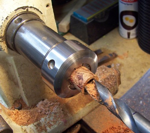

I whip it into the beall collet, no tape on, drill, 20 seconds later remove (using long nose pliars, so I don't burn myself) with hole in it and move on to the next one. In fifteen minutes, I can have about a dozen drilled. No tape to remove (which would have gotten hot and will be "baked on")
Both methods WILL work, I agree. I am lazy, and I PRODUCE. You are patient and you make one-ofs, BEAUTIFULLY!! Especially StarTrek related!!! (No, she did not bribe me). People would much rather have YOURS!!!
I agree with you for the most part Steven, but I do prefer the 360 degree support that a collet chuck offers when drilling segmented blanks.

On the wood lathe, I would use the collet chuck to drill certain blanks that required the hole be very precise. I would also use it for closed end pens, and that was it. But every time I used it, I had to mess with my alignment and even then it could change in an instant because the tail stock has a tiny bit of slop on the wood lathe. Every time you move the tail stock and lock it, it is in a different spot. The movement isn't a huge movement, but it is there and if it is off by 2 hairs, when you extend out the drill bit 3 inches, it then is amplified into 8 hairs or whatever..you know what I mean. I find that if I always pull towards me as I slide the tailstock and lock it, that helps alot, but still isn't fool proof. I love my little jet mini, but it isn't tight and tolerant like the metal lathe and the adjustablility of the jet mini kinda sucks. I can sit there for 20 minutes and get it all sweet, and tighten the crap out of it, but after a couple pens, the head will have moved a couple mil's from the vibration of a spinning blank pounding against a chisel.
So these are my reasons. I love my metal lathe. I do wish I had known about the spindle type though before I bought it. That would have changed my mind. I would still rather use the collets over the jaws in the metal lathe, but there are times I wish I could just pull the collets off so I can simplify down to a dead center. As it is, I do all my dead center work on the wood lathe.
