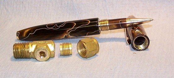

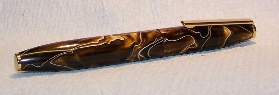

Hi all, this was another fun one to make. The male and female threads are from an old small bore water T-piece. I just cut off one of the male theads, and squared it up. I turned the nut round with a file ( of course :D) and stuck it in the cap.
In hindsight, I would try to make it thinner, perhaps by making the 'nut' look like a cb. I would also remove a couple of threads in the cap as it has too many turns to get the cap on and off.The twist is just below the threaded bit.
Hope you like it too:D

Steve - trying to be constuctive I think the idea of this pen is great. You seem to be coming up with some really interesting ideas recently. I, like you, think this pen is a little fat but I have to say that the quality of the wok you are producing at the moment is first rate.
What size brass tube did you use?

Originally posted by Pikebite
<br />....
Richard, one and a half normal 7mm slimline tubes in the main body and the other half to hold the clip in the cap. For this one, I had to leave it fat to accommodate the nut threads. Perhaps I could have made it a little thinner, as is, but there is no metal between the cap threads and the short bit of tube holding the clip.

Quick tip for anyone who is gonna try this....
drill the hole to suit the SL tube in the male threads BEFORE cutting it off!!! Trust me[:D]

A beautiful pen, and an intersting source for the threads.
"Fatness is in the eye of the beholder. I like this one, but am wondering what it would look like if the ends were closed and the clip was recessed, and,,,, There are so many more possibilities.

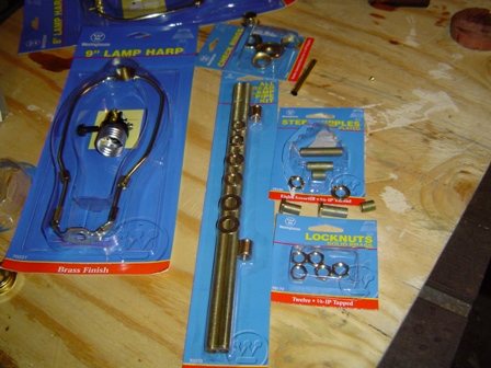

you'll have to guess what im working on[:D], but
did you know that the standard brass lamp repair kits and fittings like these,from home depot. The long one is a 12" hollow threaded rod.

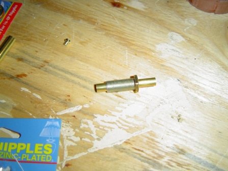

Will accept a 7mm tube right out of the box.....like this.
<br />
actually i just found out......[}:)]
So now you have a lot less cutting and drilling to do.
pete
btw, my whole purpose in life now is to find out something clever like this that you didnt know....you didnt know did you ??[:D][:D]

Joe, you are supossed to be able to write with your pens??????[}:)]
I guess if I was writing an essay, it may be a bit uncomfortable, but this was just an exercise. I cant remember when I used a pen for more than signing something.
Pete, oh Pete.... my little brass t-piece cost me a couple of pence.
For me to get that rod from Home Depot, I would have to pay airfare,hire car, hotel.....just kidding. That is a great idea, but is it brass or brass plated? I try to dull the threads a bit which would take the plate off, if it is.
