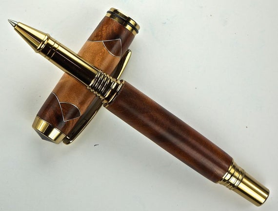

Here is another variation on what I have been doing. I have seen this done here before and have done this myself but without the aluminum. This is by no means my idea but I really liked it when I saw it.

Mike, at the risk of being greedy, could you please explain how you got those little pieces into your basic plan as laid out in your previous post? Did you need to use a router? Thanks, Russ
All you need to do is to visualize what is going on with each cut and turn. I know that if I put a single 45 degree angle I get some of my scallops. Now once that glue job dries I take it back to the bandsaw and cut it off right at the spot where the aluminum folds. Then I turn the blank 90 degrees cut at 45 degrees and add aluminum again and add another piece of thuya that has been cut at 45 degrees. This process if actually not all that difficult but it is time consuming and exact. With every piece you cut you need to sand smooth the surfaces and sand to fit if you want a perfect fit.
Easy for you to say, but for those of us who are visually challenged ....":wink:
I have trouble with that too. I have seen scalloping like this done by others and realized what was going on after I experimented a bit before I started using the aluminum. Then I tried turning things 90 degrees on another pen and realized from what I saw from that, that this was how the others had gotten the scalloping to work. Then I tried it and it came out like you see it.

Mike with each pen you are putting out you are stepping up your game. This by far is the best looking one and if you combine a few of the earlier ideas you will have a true knock out. I can't wait till you start turning the blank 22.5 degrees and doing scallop work. The woods do compliment each other for sure.
I am hoping to be able to get in my shop within the next 2 weeks. Things on the job have slowed down abit.
This pen as well as the others and by the way congrads on the front page, should be some inspiration for others to give segmenting a try. Sooooooooooo many ideas and combinations and designs can be done. Makes the pen look a whole lot better and classier with a segmented blank of this nature. Keep up the great work and look forward to seeing more. :good:

Well I have not done a celtic knot so you are one up on me there. It is all the same ideal though. The angled cuts appear to be round when you turn. Same ideal here.

Well I have explained how I made the mods. All of the pens use an easy to get 45 degree angle for everything. I am thinking about doing a much steeper angle so I can get a really long arc? I am making a few simpler pens right now and will get back to more of the segmenting in a day or so.
