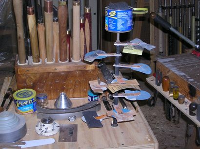

I picked up an idea for keeping my paper straight, from a friend in Australia. It's called a Sandpaper Tree.
1/2" all thread for the center post, bolted to the top of my rolling tool table. On top is a peanut can for my 0000 steel wool. The fingers are just two cut outs of tin for each finger, with the ends bent separate a little, to allow easier insertion of the pieces of paper. Separated by short pieces of 1/2" id tubing. Finger set for each Grit of paper - 80, 120, 180, 220, 320, 400, 600. Turn the fingers to any direction you want to keep 'em separate. ( Micromesh pads are kept in a small box attached to my Little Vic's table.)
