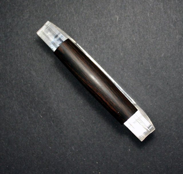

Terry--there's no right answer to the question you pose. Even the responses leave a lot of room for debate. I offer a picture rather than a grit number.
<br />
This is a piece of African blackwood that, in my opinion, is ready for sanding sealer. It will probably take two coats, both of which will be sanded back to bare wood. At that point I should have a nice level surface to start finishing...at least I hope I do.
