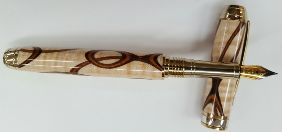

I stop at 320. Then 3 coats of thin, 5 coats medium. Set overnight. Sand CA 320, 400, 600, 800, 1000, 1200, 1500. Then Novus heavy and fine scratch remover.
