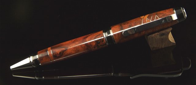

For your photography question, I've done a lot of black background shots. The trick is the get a grey card and put it in place of your pen, meter off it, then manually set your camera to those settings. Replace the grey card with your pen and shoot the picture and it will come out "perfect".
I quote "perfect" because even though the lighting is adjusted perfectly the shot will often appear dark anyway.
You can look at page 5 and 6 of my album to see the black/reflective background shots. http://www.penturners.org/forum/photo_album_view.asp?cname=Main+Album&mid=3449&cid=3762&page=5

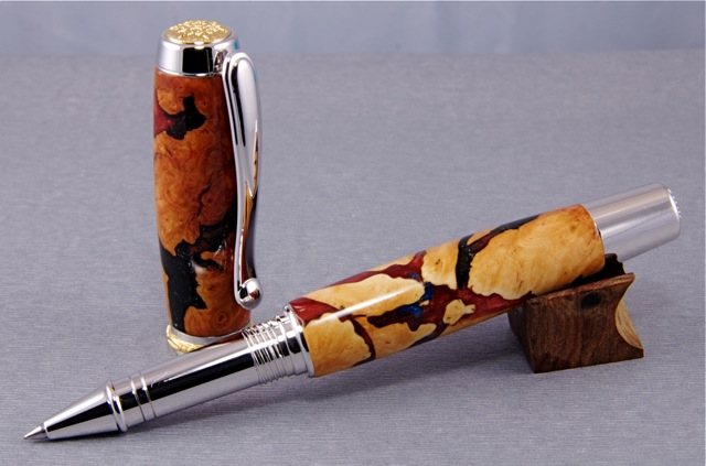

But I had enough people complain that I stopped doing it. Now I try to pick a contrasting color at the same "intensity" level as the pen so the pen stands out and I don't have lots of contrast between the background and the foreground object.
One of these days I have to go buy a good background. That one is just a "heather grey" manila folder opened up. [:I]
