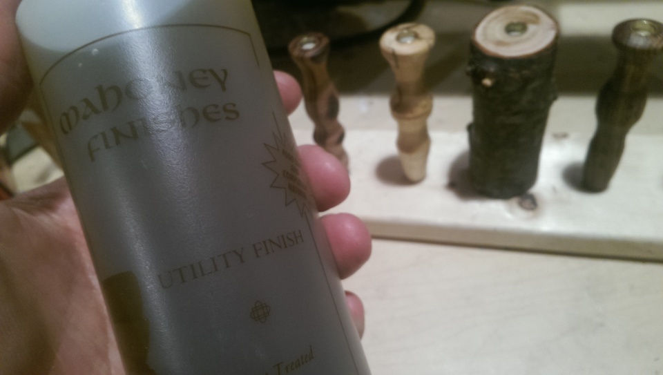

ic Rockler has Mahoney's utility finish heat treated filtered walnut oil. Does anyone know if this is the same product? Can I use it under the Pens plus? Can I sand with it?
Any of you sand with this type of oil before putting CA on? Or would the oil mess up the CA? I like wet sanding my wood for dust sake.

Mahoneys should be just fine as a replacement.
I wouldn't want to use it under ca.
I personally use the pens plus in tiny amounts between grits with excellent results. No plain oil.

Mahoney's doesn't have a metallic dryers. I've used it on a few bowls and days latter it can still weep a little oil out the pores. I tried it on red oak and I had to blow the oil out of the end grain pores as it actually stayed wet for weeks. I was told to wash it with soap and water to get it to stop weeping the oil. I wouldn't use that as a substitute.

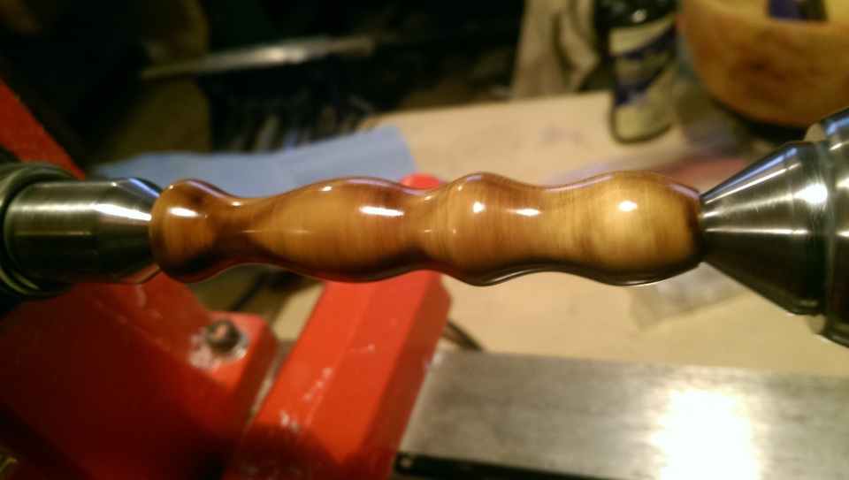

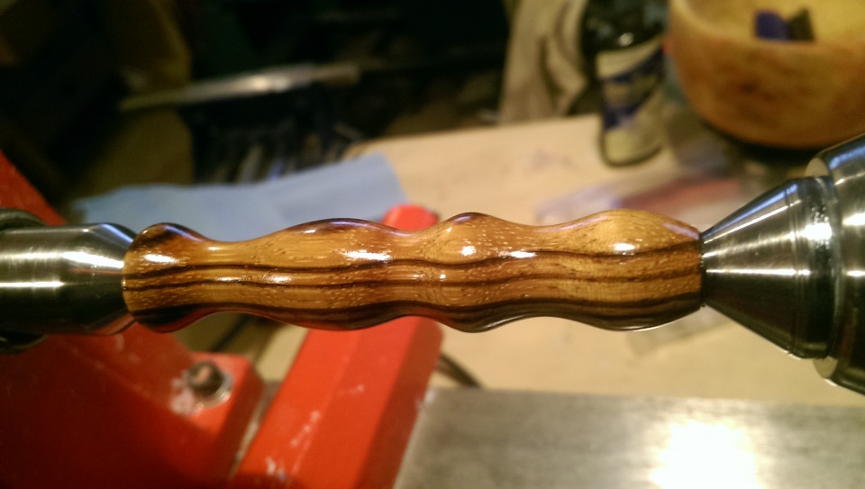

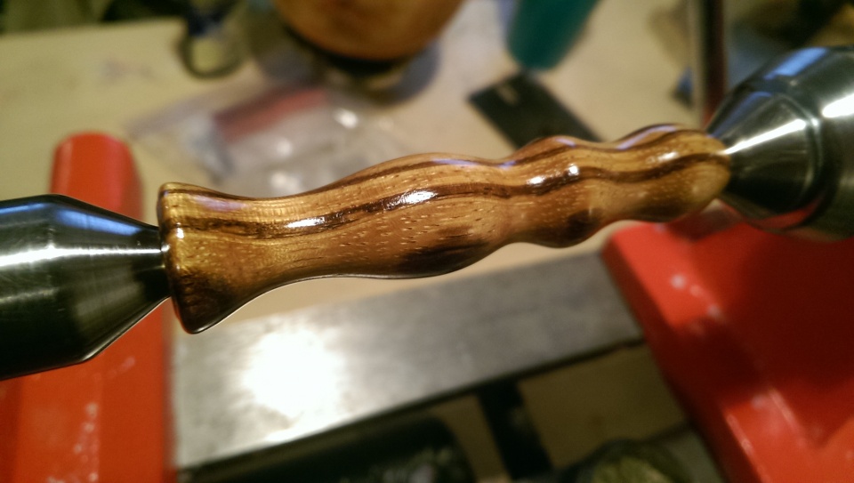

the pictures are hot off the lathe. This is a zebra wood sewing seam ripper sanded to 600 grit using honies finishing oil then with doctors woodshop pens plus (3 costs). I did not yet put on the microcrystalline wax.
Mahoneys oil did not feel or seem to be different than doctors wood shop.
