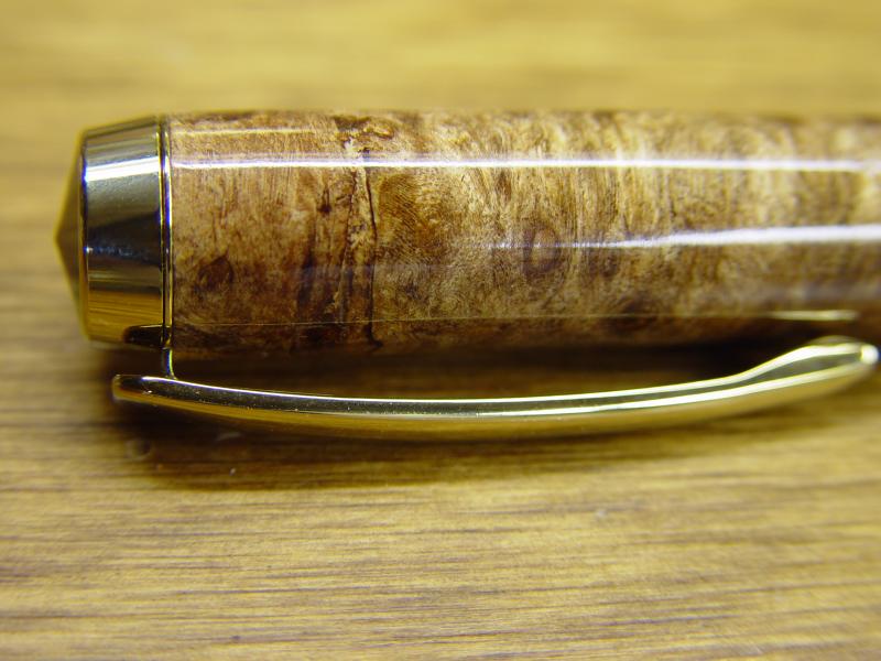

Same here as Hank....learned (present tense maybe:)) penturning recently and use roughing gouge, spindle gouge if needed. Have the skew and many other tools but since surface is as smooth as with sandpaper, why use them, or the paper? Keep gouge very sharp and take dust off the last several (actually numerous) passes. Box elder looks clean and beautiful sharp patterns remain. Here is a maple top.
Chris,
That does look great and a lot can be said for a smooth "cut" versus sanding.
In flatwork, a few people use a "scraper" instead of sandpaper and the "cut" grain from the scraper's edge looks clean versus sanding even with 400/600 SP. The difference is not always apparent, but when it is, it stands out. Different woods seem to allow for sharp cuts but some don't.
