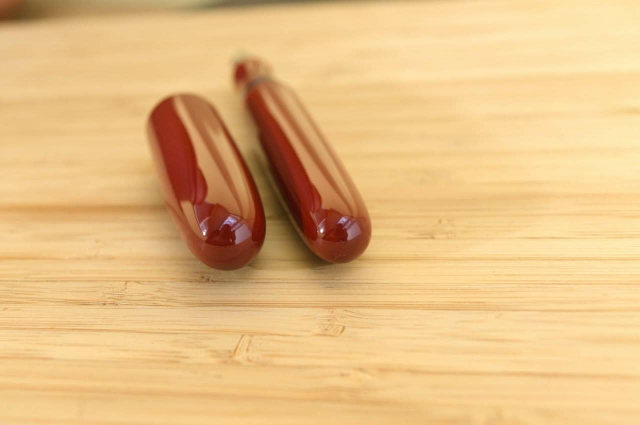

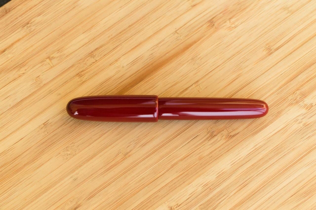

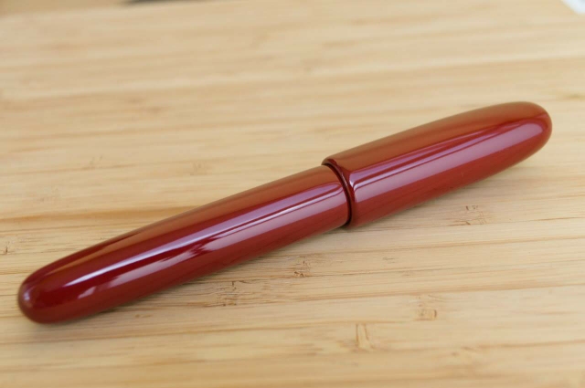

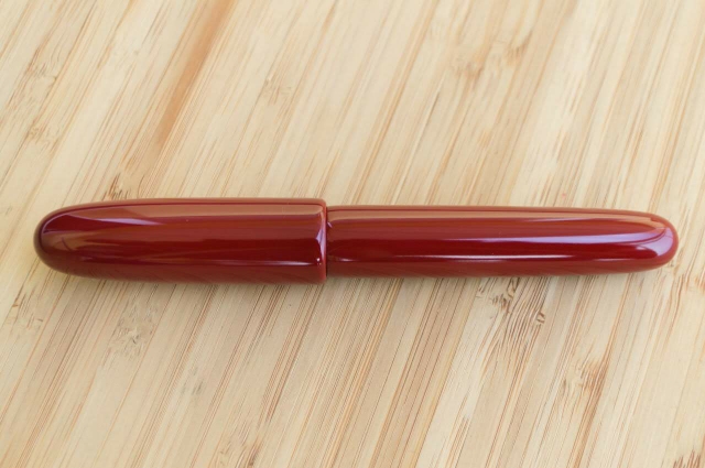

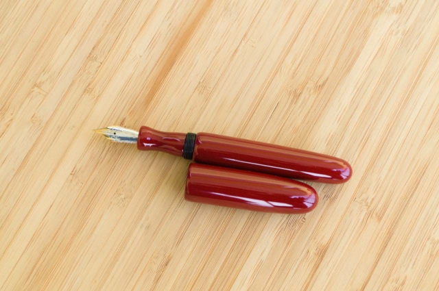

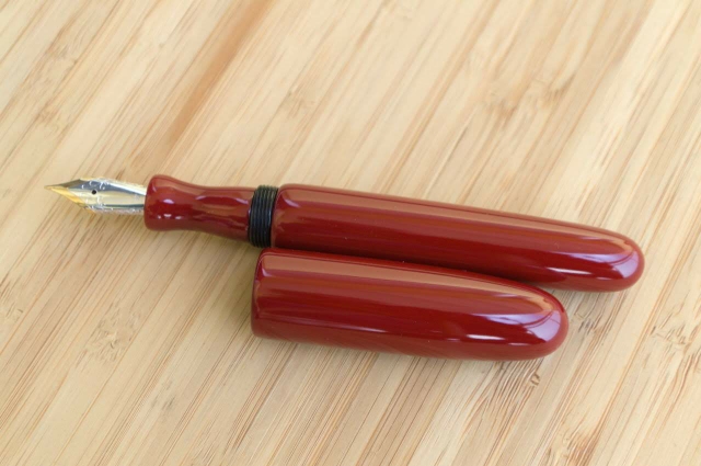

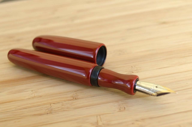

Hi all,
This is the Samurai model in Aka Tamenuri finish. The Tamenuri is lighter, allowing more red throughout the translucid layers.
Nice day all
Teo

Very pretty! Can you share how you preserve the brightness of the red coloration? My red urushi (Kijome/Vermillion) darkens a great deal in the furo, even at relatively low humidity (65%) and temperature to slow down the during process. Any advice?
Actually this is darker due to translucent layers to provide a Tamenuri finish.
Depends also of the Urushi type and pigment, mine it's a long dry urushi, it needs to stay in furo longer even 3 days if necessary.
You can also put it under the sun to light it up.
If you add also syuai with will get darker so you need to see what mix it gets it perfect, it's a matter of practice.
