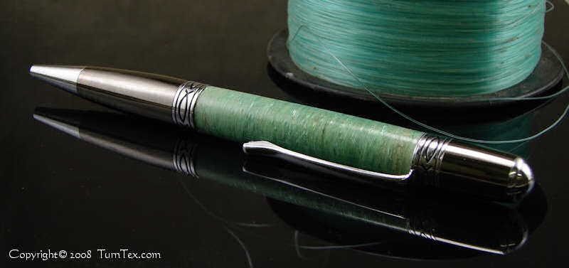

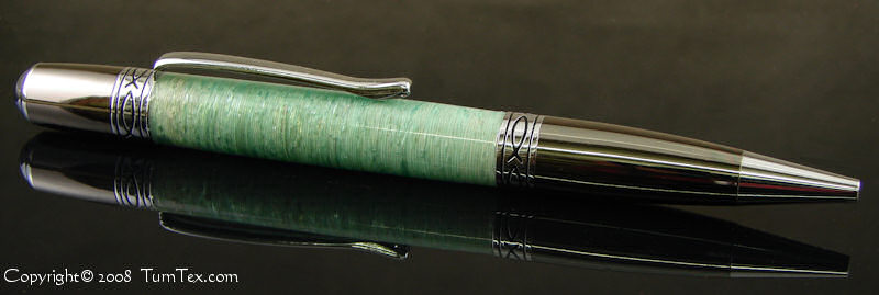

Here is a fishing line pen a did a few years ago. It was really popular with my brother-in-law who is an avid fisherman and TX Game Warden on Matagorda Bay area.
To make it, I simply painted the tube and mounted it in the bushings. I then applied a little bit of CA on one end to start the fishing line and spooled it on the tube by turning the lathe by hand. I made one pass and then stopped and soaked it in CA. Then another pass, etc until it was just above the bushings. Then turned it down and applied a final ca finish.
