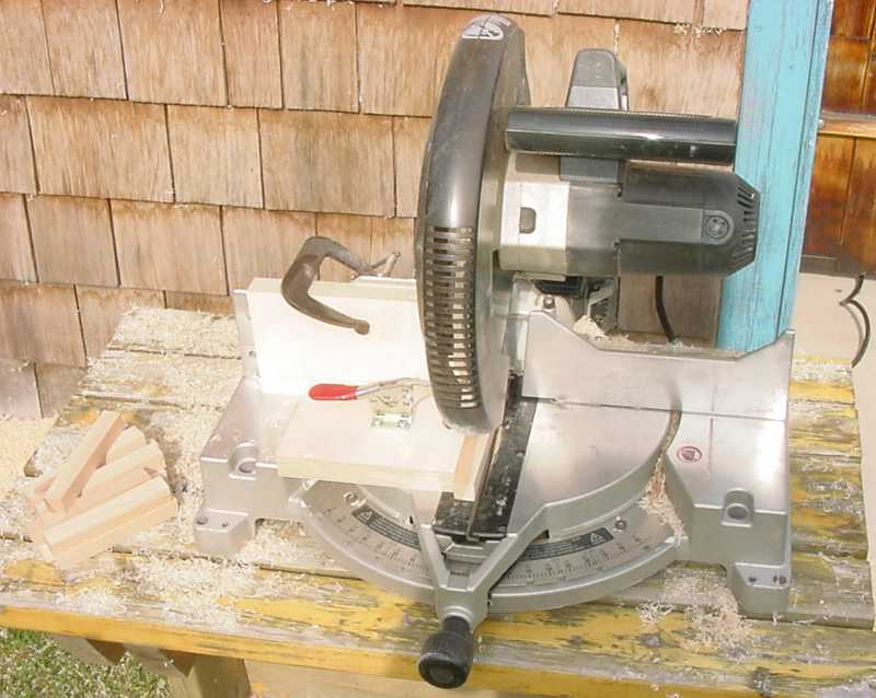

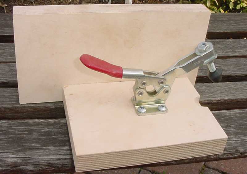

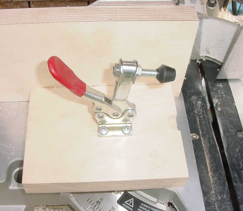

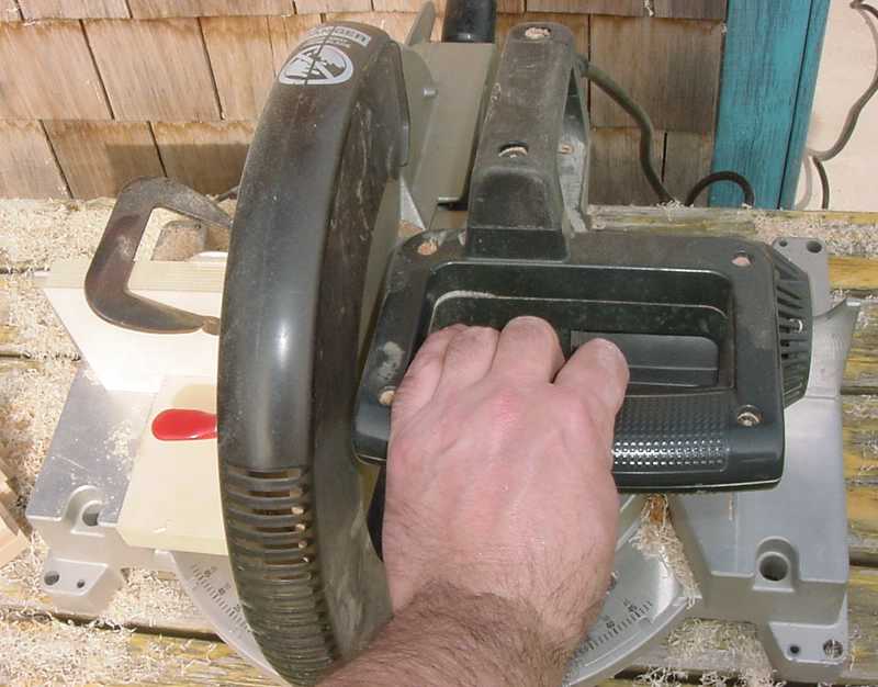

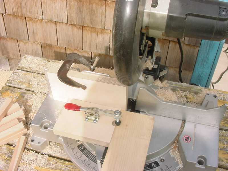

There have been debates as to what tool(s) work best in terms of preparing pen blanks for cutting. My answer is that it's NOT the tool but rather the jig that gives the tool it's effectiveness. I'd like to share a very simple but yet practical jig for SAFELY cutting up pen blanks from flat stock. The best feature is that all cutting is done with a one handed operation and that your fingers are far removed from the saw's blade. The secret lies in the hold down clamp and hopefully the pics will convey it's function.

Two things I'd like to mention that I noticed in the third photo
Standard miter saw blades are meant for cross cuts. It's not always a good idea to rip boards this way.
It would be a good idea to place a back stop behind the full width of the board.

You're sharp(no pun here) Ron. The third pic contains a board that actually is for modelling purposes only. As you correctly pointed out the mitre saw is intended for cross cuts and that is what I normally do. I cross cut the flat stock to a 5.5"-6" lenght prior to mounting the jig. In this case I had already cut my blanks prior to taking my photo. If you are really sharp of vision you will also note that I'm cutting with my left hand but that is because it's difficult to 'model' for pics and snap a pic with the other[:I] I really do have four fingers and a thumb just in case anyone was wondering[8)] And if I have my way I fully intend to keep them all intact. Don't want to disappoint 'wifey' when she's ready 4play [;)]
