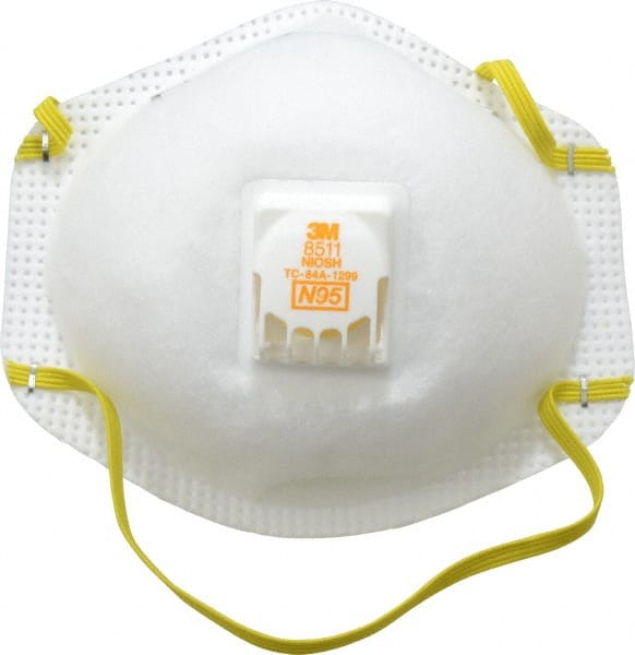

As far as the mask goes there are plenty of dust masks out there that have vent holes so that it does not fog glasses. Not all masks are for all jobs so choose the ones that are designed for what you are doing at the time.
This is a good one
I believe this might just be the exact mask I use... I guess I just breathe heavy or hot..?
