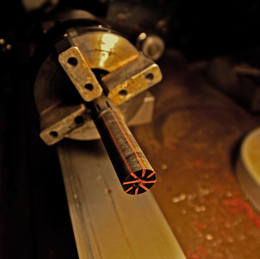

So when you start segmenting woods and the one of the woods has been dyed or stained and when you apply the finish the dye bleeds and ruins your whole project...
The truth is some companies that dye or stain wood understands how certain dyes and stains run or bleed when a clear finish is applied and they don't use dyes or stains that will bleed or run ..
My advise is to buy your stained or dyed woods from companies that have their $hit together ...that are professional and don't pull this crap on there customers ...
