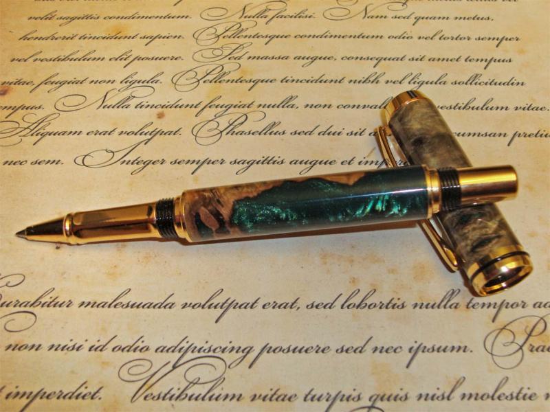

You guys are great. I appreciate all your comments. I guess I have just been getting an extra dose of "experience" this week :)
I have a 60 degree live and dead center on their way now. They were put on hold with the Canada Post strike. I did order 1 set of Johnny's bushings to try them out since I had to get my dead center from him anyway. I hope they didn't get lost in the mail.
I have made some really nice pens so far. It was just a string of screw ups on 4 consecutive tries (just remembered it was 4 not 3). The 4th one was that a chunk of wood had gotten torn out while drilling a burl blank and I didn't notice until I started turning it down.
Here is my best pen so far. I would show more but I haven't taken pictures of most of them.
