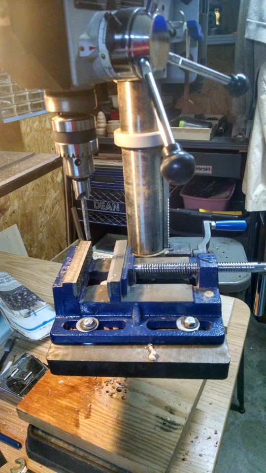

Here is a setup I use on my DP. Custom fishing rod builders tried Gorilla glue when it first came on the market but didn't like the expansion of the glue on custom grips- too much to removed when turning the grip. However, it would be an advantage here. Expansion would fill the gaps but you shouldn't have the gaps in the first place. Check your drilling methods and find out what is causing the holes to be oversize. I had this same problem until I changed to the photo setup. I viewed Ed Brown's video on Exotic Blanks about drilling and line up the blank with the drill bit. I secure the blank in the vise (not vice as I have too many of them as it is) and move the vise so the drill bit is on center. Then- drill away!
