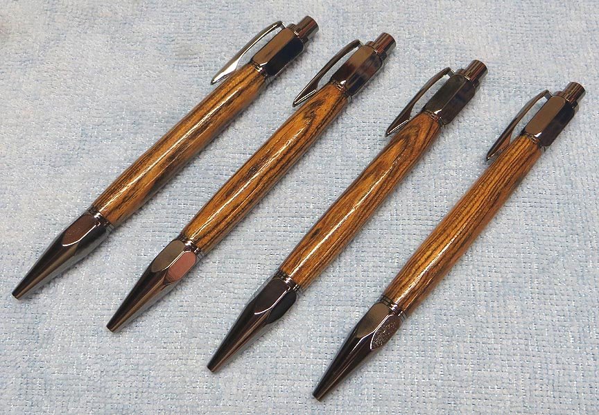

I like bocote myself. Turns easily and has great figure. I finished these with spray lacquer.
