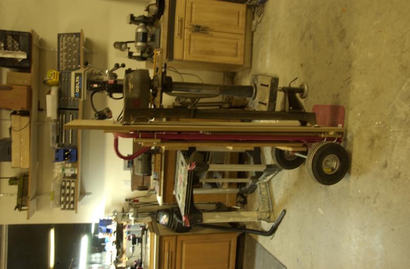

I made one from a dolly that mimicked the ridgid chopsaw cart. $37.00 for the dolly 2 pairs of hinges. 8 U bolts, and some mdf and scrap lumber. it stores vertically.

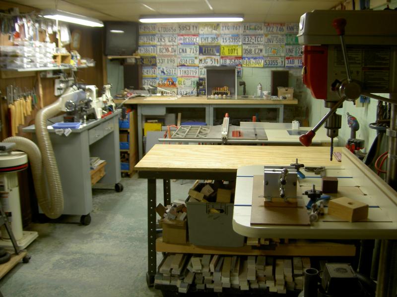

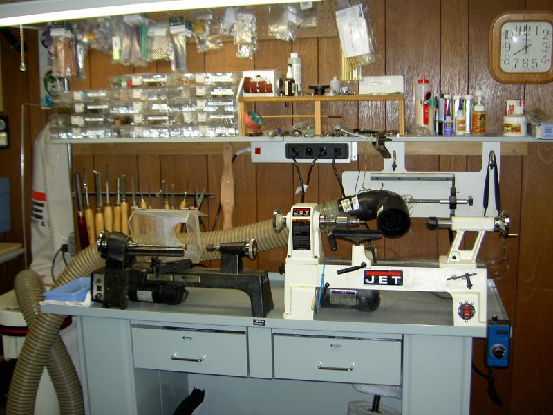

Hey, where is your other shop, the one that you actually work ing
The pictures look like show shop.
Very nice and clean, Mine only looked like that once
they day I started to work in it, lol
