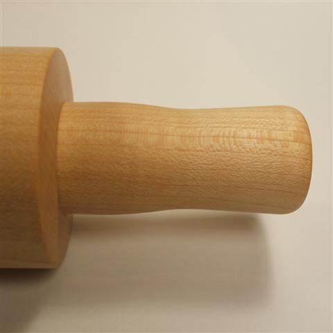

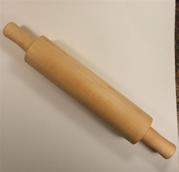

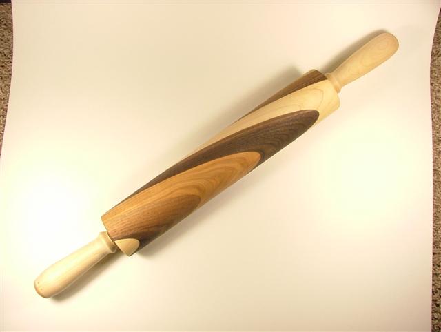

I have made them with free turning handles and with the solid handles. The free turning handles take a lot longer to do. The benefits to the solid handles like the corian ones posted above are that no gunk from your baking get caught in between the handles and the pin itself. The solid handles are much easier to clean. I make mine about 2 1/2" diameter and turn the cylinder first then work on the handles. The tricky part is getting the handles the same. The overall length is about 17" which is the max on my lathe. If I could go longer I would go a bit longer. Pictures of both styles are shown below. I also did a laminated pin with solid handles but can't find a good picture of it.
