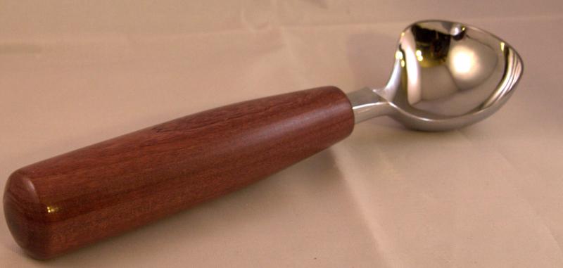

Got it today. I finished an ice cream scoop handle with it. Put on about 12 thin coats, buffing between with the #7 dry micromesh pad. I used a paper towel and just put on 4 or 5 drops each time. It dried almost instantly in our 16% humidity. I put it on with the lathe spinning, and it resulted in a slightly matte finish. Which is fine for an ice cream scoop. Not sure I would like it on a pen. I really wanted the finish for larger items that I've been using Mylands on, such as bowls and tea lights.
It is purpleheart. (Note, the handle was ordered oversized for someone with arthritis.)
