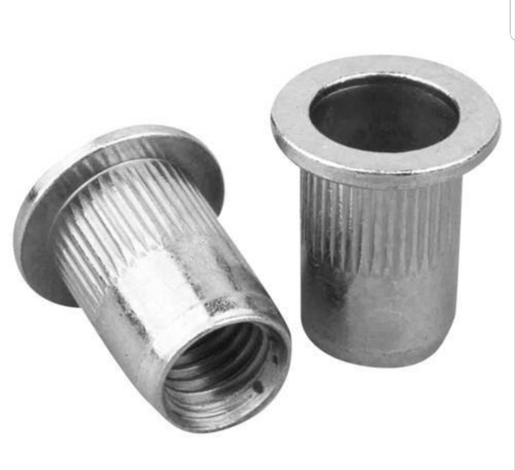

At 50¢ a piece these are much better than $2 a piece for the regular inserts. I just cut the collar off, put on some glue, and Bob's your uncle.
Any other ideas for inserts?
