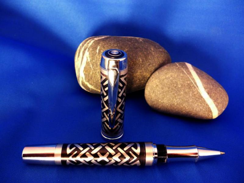

So, here is a pen which you may have seen recently..... but its been upgraded.
attachment.php

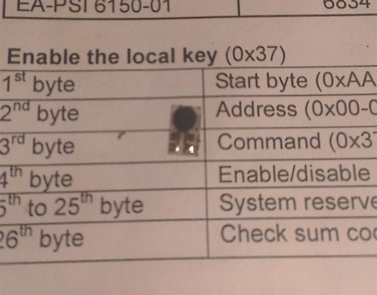

Here is the microchip. care has to be taken as its only 5mm in width, and is very easy to overheat while soldering if your not careful.
apologies for the blurry pic but this camera doesnt like objects that small.
attachment.php

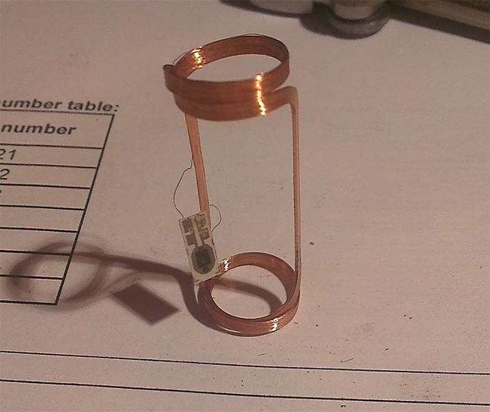

Here is the chip attached to the copper coil. this component is much more critical than you think. Its frequency is determined by how many turns of magnetic wire there are, along with its length. its layout has a bearing on how much gain it has. (range from the scanner).With it rolled up in such a fashion the range is reduced significantly, though never the less it does trigger the door release, when touched against the reader.
attachment.php

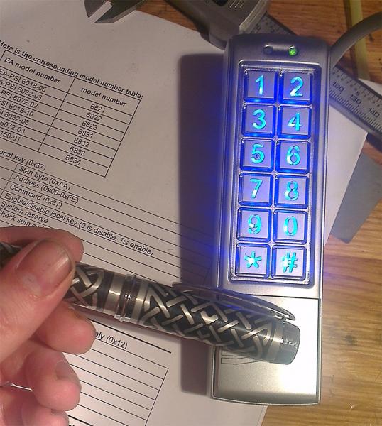

And here is the pen with the coil mounted in the cap, operating the door entry system. Success! - but never the less theres plenty of room for improvement, this was merely a mock up test out the theory. Faradays law plays a key role with mounting an energised coil such asthis in a metal tube, let alone the entire penbody being constructed of aluminium such as this. The metal soaks up the RF radiating to the coil so the pen would be better made from acrylic for instance. this can be improved however providing that the metal is not in a closed loop, or a faraday cage as some might understand. I wont go into the details of radio signals and how they are affected by their surroundings as im sure it will bore most :wink: needless to say i will be looking into other ways of winding a coil etc which would better suit the design of a pen etc, but hey! i have every intention of using my carry pen to let me into my pen studio - so this will be a fun venture with many models im sure
attachment.php

Wouldnt be an issue, the master code can be typed into the door entry system, and the chip of the lost pen deactivated. I would just then activate another pen which has a chip built into it.
up to 1000 pens can be registered onto this system and independantly controlled using their registration number (this pen is reg number 002).
Centrally managed systems give more advanced options per user code with relay outputs.. to put this into perspective, my sons door entry fob would allow him access to the workshop, but the system would isolate the machinery ringmain preventing him from turning on any of the machinery etc.. or can be controlled by hourly set days access permissions, and a supervisor override allowing the machinery to be used etc etc... the possibilities are endless.
nice subtle touches like the lights switch on for you as you unlock the door automatically.
