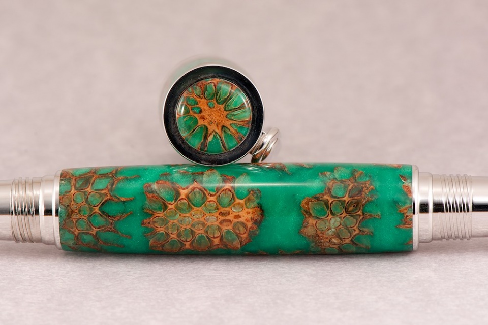

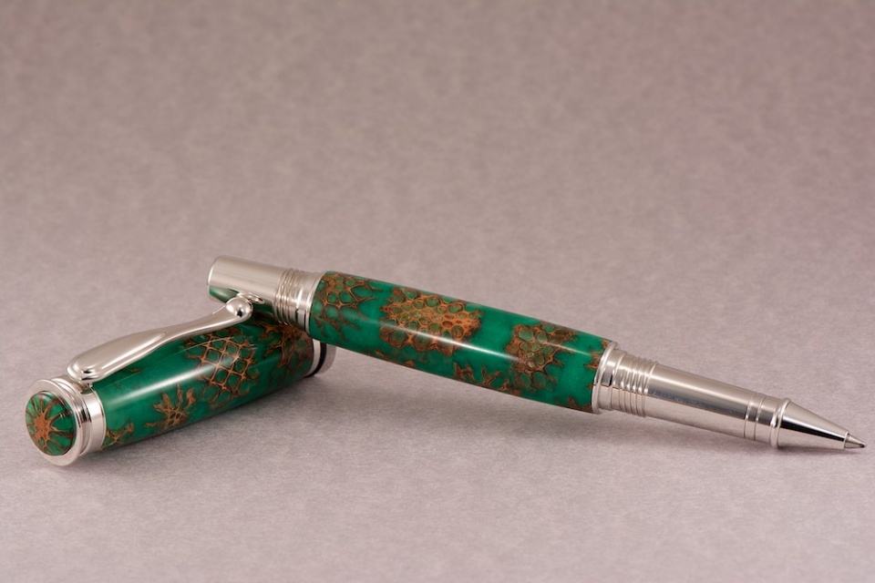

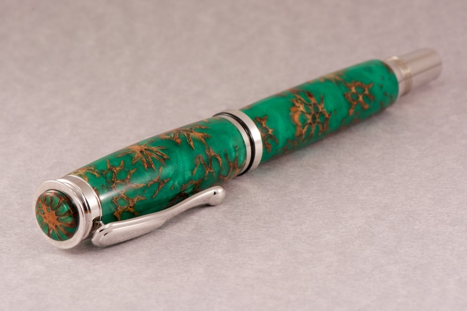

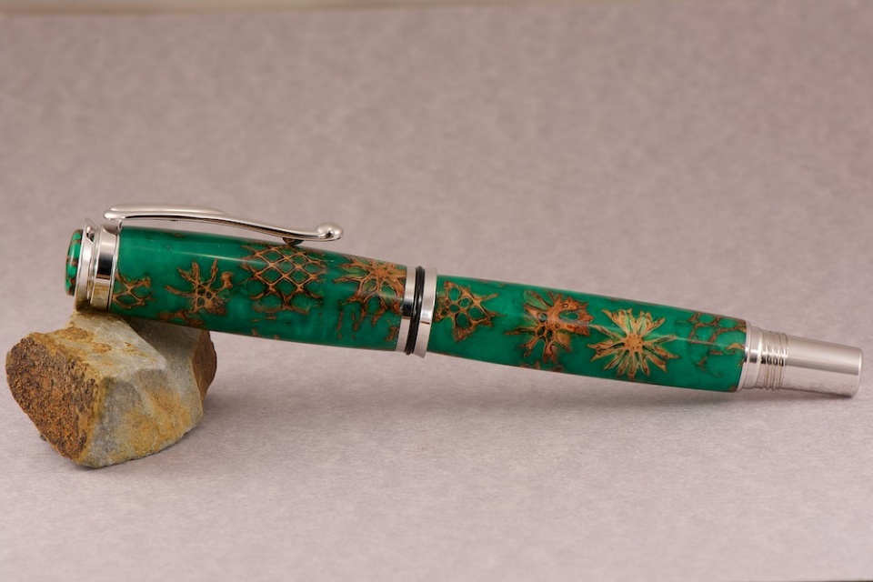

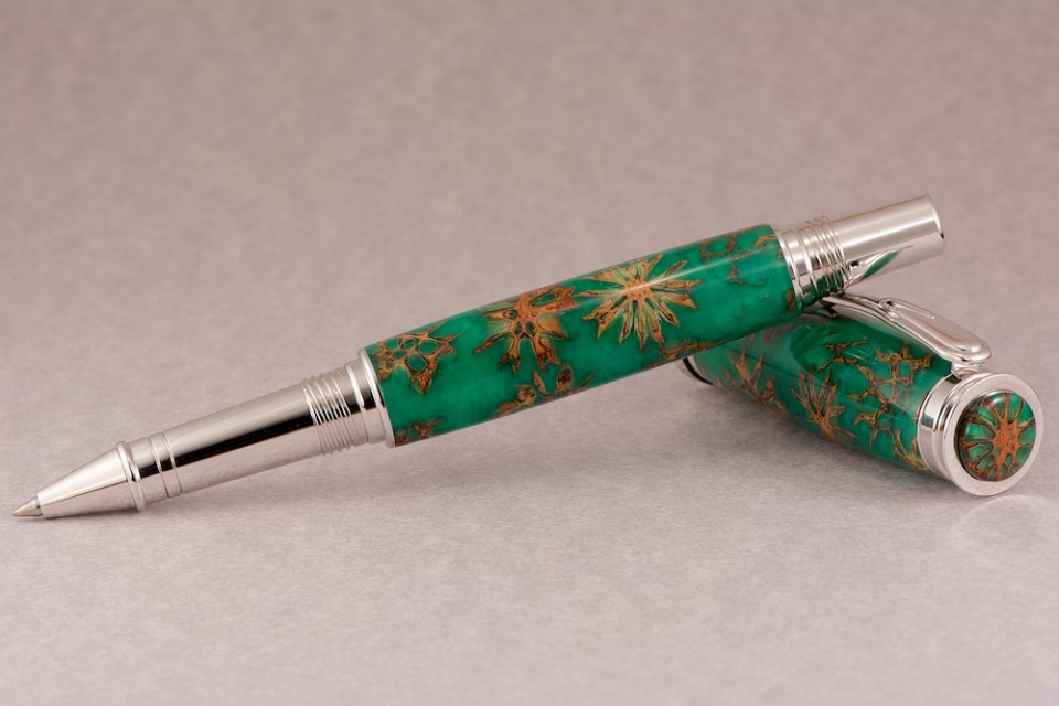

This is a blank from my second She-oak cast.
I had a bit of trouble with the cap, the resin cracked when I pressed the hardware in. Had to glue up another and re-turn it, this time I reamed out the tube for a better fit.

Finial is a nice touch! Makes everything blend....
Looks similar to our 'American Sweetgum Pods'. Very cool!

Very cool pen. I also think it looks very similar to cast sweet gum balls. And I also think the finial ties it all together. Great job! :good: And that's one of my favorite kits.
I took a few pics of the tree/branches and 1 pic of the ground that has to have at least 3" thick of old pods, just unbelievable.
Our sweet gum trees do the same thing. Some years are worse than others. We had 1 in our front yard. After about 5 years, I had enough of the blanket of gum balls, and had it removed. That was long before pen turning though. But they are everywhere, so if I ever decide to make a few cast of them, there is not a short supply.

I've tried making one of these myself and ended with a blow out. You did a great job. Ditto on what folks are saying about the finial.

Ironwood,
Did you need to 'harden' the pods prior to casting?
Or just give them a go going over with some thinCA during the turning?
Scott (assuming some pressure casting here too) B

Ditto repeato from me too on the finial. :wink: The whole pen is cool, but your attention to detail in getting the little 'bug' central really makes it stand out.:good::good::good:

Ironwood,
No prior treatment on these Scott, they are hard little suckers.
I cast them under pressure to try and get the resin right into the seed cavities, it seems to be working.
They do require a drizzle with CA when getting close to size.
Thanks Skip. Yeah, I had to trim two sides off the blank to get the pod central.
