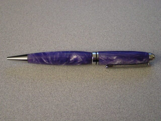

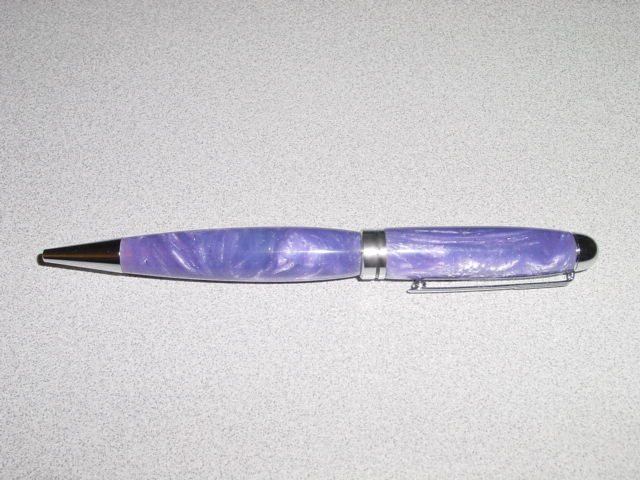

O.K., last night I turned another PR pen with input given here. I must say even with a scraper, I still managed to get sandblasted. It wasn't quite as aggresive as a gouge but not a whole lot of difference. I still had to rough it out way oversize, skew it down to just a little oversize (.040-.050), sand it down to 12000MM (probably overkill) and then Hut's plastic polish. Not bad process given the end result and I'm sure I'll get better as I go along.
I do have one last problem though. Air bubbles or clumps of unmixed powder. I tend to think that it's the powder since I made a pink block using liquid dye and I see none of the specks. It doesn't look bad or anything but I'd rather not have them. If when I turn down the pink pen and find no inclusions (lack of a better term) I'll start buying the dyes but to use up my stock of D&S powder do you have any tricks in mixing? Maybe I used too much kind of like when your a kid making koolaid with 8 cups of sugar. For a 9oz mold I use 4 popsicle stick scoops of dyed powder and 2 pearlwhite. For a 4oz I'm using 2 scoops of the dye and 1 of the pearlwhite. I first mix in the catalyst and then I mix in the powder. The whole process takes about 2 minutes for a 4oz and maybe around 3-3 1/2 for the 9 oz. I feel I mix it pretty good but something isn't quite right. If you have any input please let me know. Thanks
The flash really showed the inclusions but, honestly, you have to be about 6 inches away from the pen to see it in normal light.

Hmmmmm...haven't had that problem yet. How are you forming your blanks, and how many drops of catalyst are you using per ounce?

Sorry, but I can't help you with the powder dye question as I use something totally different from the rest. All in all, I think you made a fine looking blank, Chad. [^] Keep practicing and you'll get the result you want.

Chad,
Your pen looks great to me. Having attempted to photograph purple pens, I also HAVE to congratulate you on the color. If the photo is accurate, you have shown a color I have attempted to shoot a number of times-without adequate success!! Nice job!

To get this color in a 4oz mold I used 2 scoops of D&S ultraviolet marine and 1 scoop of pearlwhite pigment
