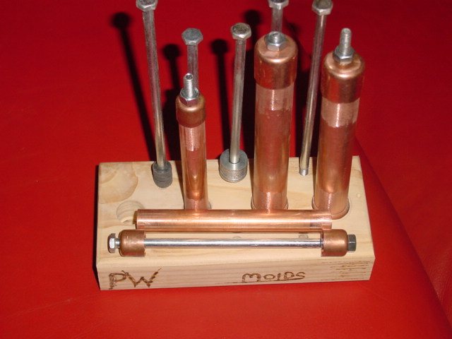

If your going to do any casting, I suggest a little reading before hand. [:)] My alluminum molds were a bust. Kenn Osborne has a good article on his "Perfect Mold" in our Articles list. This was my interptaion of his instructions. Hope to try it this weekend, They look good, wether it works or not I don't know ! [:D] Anthony

Anthony,
You're cooking with gas now. I have heard good reports on the copper tubing molds, I just have not tried them. I look forward to your report. Keep us up to speed with your results.
Are you gluing the snake skins directly to the tubes. If so, let it wrap around and glue with Ca and allow a small overlap and glue it dowm. Surprisingly, the seam is not very visible once the casting is made. Good Luck and Do a good turn daily!

Don, I am overlapping a touch. Also, the guy I bought the skins from, advised my to paint the tubes brown. He makes all sorts of stuff from snake skin and he told my to do that as it holds or enhances the color of the skin. Happy New Year, Anthony

Personally I did not like the copper tubing molds. They are harder to get the bubbles out of and you can't see if there are voids. Plus you have to goop everything up with vasaline.
I am not knocking it, I just tried the tubes and a plastic mold and liked the plastic mold better.
