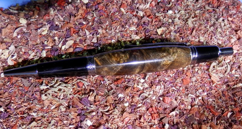

stabilized burl
I turned this one last week. It was my first stabilized turning.
