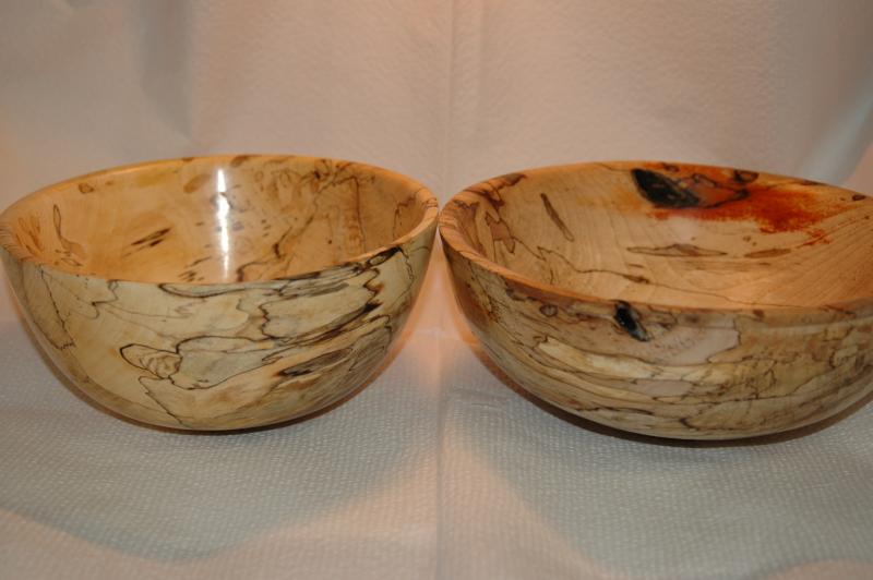

Two pecan bowls from more of the wood i collected from the trash pile.

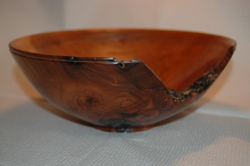

One Black Cherry bowl from Wood we cut down to put in a parking lot at our church.
Question: Can someone tell me what caused the orange stain in the pecan bowl? I've had several people ask and I don't know. All I can tell them is it's either a mineral stain or from bugs. Can someone tell me what it might be?

....Question: Can someone tell me what caused the orange stain in the pecan bowl? I've had several people ask and I don't know. All I can tell them is it's either a mineral stain or from bugs. Can someone tell me what it might be?
Nice save there. Ref the orange staining, I have a piece pf spalted pecan that has the same stain...I ruined a bandsaw blade while cutting it...it had a couple of hidden nails in the wood and the area around the nails had that orange stain...so, I concluded it was rust stains but don't know for sure. Great bowls!

Given where you live, my guess is the red/orange stain is mineral. Maybe some iron traces in the water supply.
Another posibility...When I lived in Albany, GA the commercial pecan orchards would inpregnate the ground with a chemical barrier to wood boring insects. The chemicals would stain the wood in the new growth for a couple years.

I finished one of the pecan and the cherry with bethlehem friction finish after I sanded to 600 and applied EEE sanding wax.
The other pecan, I sanded down to 600, then added CA glue, EEE sanding wax, then friction polish, buffed with buffing wheel. It had a few soft spots that needed stabilizing. Both pecan bowls had to have CA glue to help stabilize while turning.
Still working on a finishing process. All my finishes are applied on the lathe.
