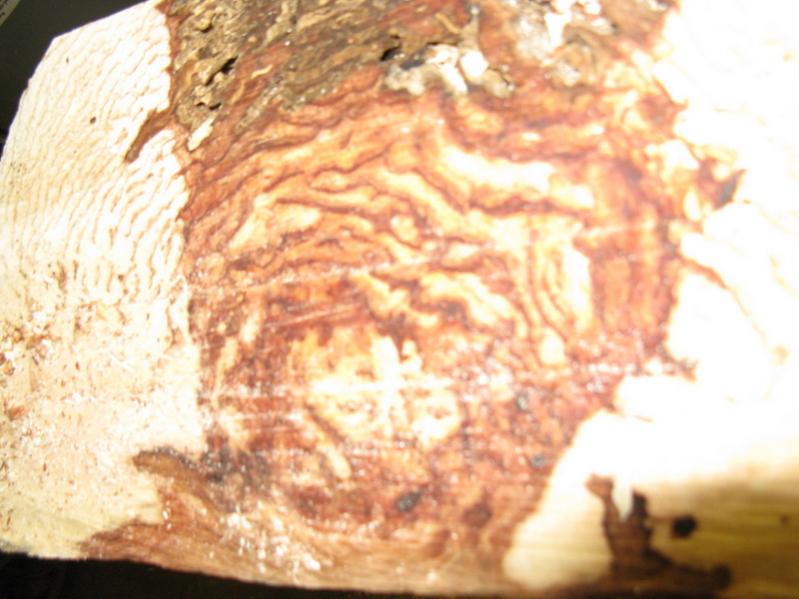

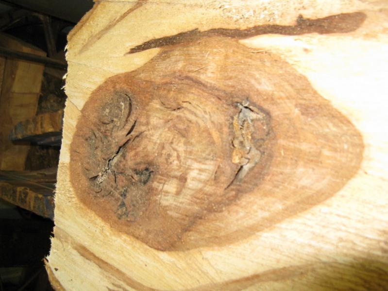

I got this Hickory Burl last week and just ain't had any time to spend with it.
Must of made it mad because it started busting apart.
Well I caught it in time-----no bowl but there should be some awesome pen blanks.
here's what it looks like now----I will get it cut into pen blanks later today---I am going to Anchorseal them.

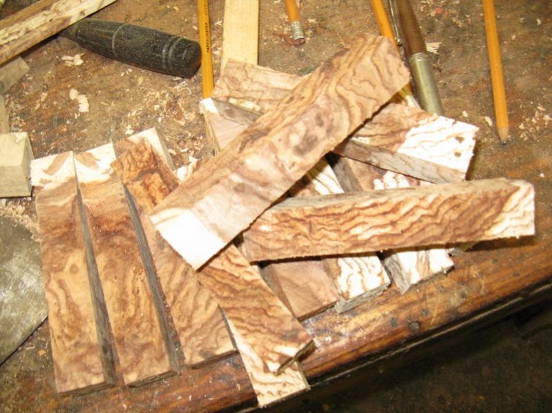

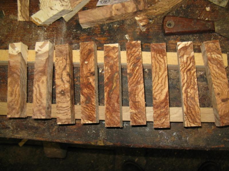

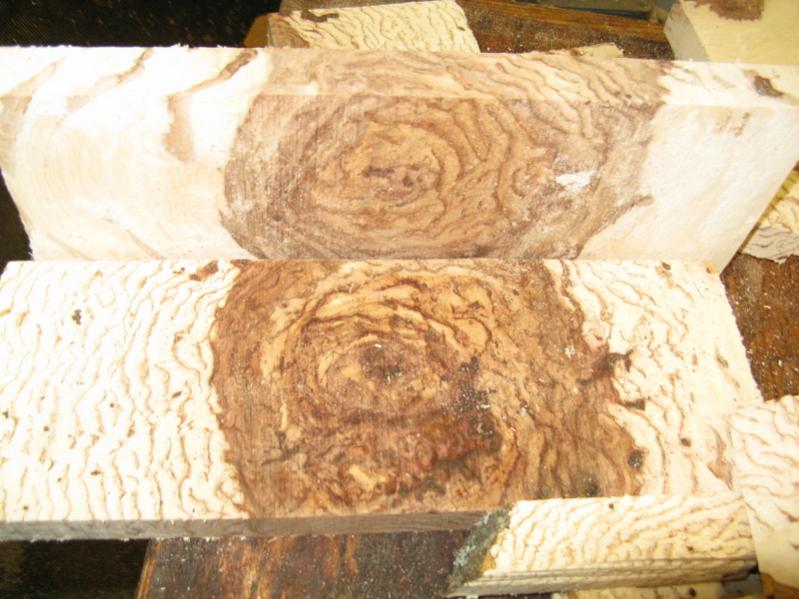

Here's what they look like now. Anchorseal will take care of them.
Oh the Misc stuff stacked on top belones to SWMBO.

I have cut 100's of burls---if this one was left alone it would busted to the point that there would of been nothing left.
It's been very wet here and she was loaded with water.
Plus have you ever tried to resaw dry Shag Bark Hickory-----not fun.
Gary Max
Oct 30, 2004
6,224
Southern Kentucky
Fred ---if I would of roughed it out the day it arrived and boiled it-----maybe that would of worked.
But in the long run------Killer pen blanks work for me.
