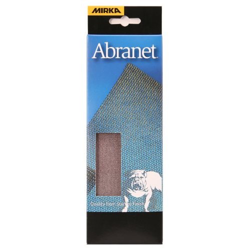

Abranet sources
Thanks for the detailed replies! Your encouraging reports may help some here to give this a try.
I've scoured around and found that PSI (www.pennstateind.com) has a 10 piece pack of 5 grits for $ 10.95 in the 2-3/4" x 5" sheets, 120x 180x 240x 320x 400x grit - 2 of each.
Amazon.com has 10piece packs of single grits:
- 9A-149-320RP 320grit $ 5.82
- 9A-149-400rp 400grit $ 6.29
- 9A-150-600RP 600grit $ 7.46
If you purchase 25$ worth, the shipping is free from Amazon.
I'm going to buy the 5-grit pack from PSI to give them a try, then buy the single grit packs when I understand which ones will work the best for my needs.
Thanks y'all for your valued input!
Bruce in TN.
