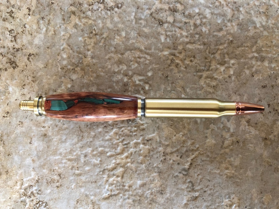

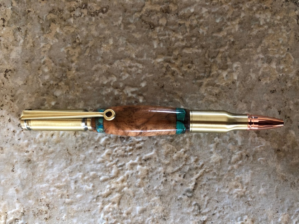

Hi folks. In this video I show you how I repair a pen that ended up having a big void in it. The second picture the blank had broken at the ends and the process is the same.
