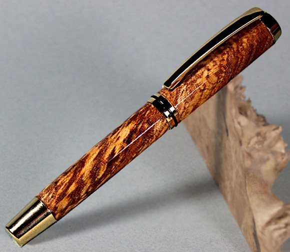

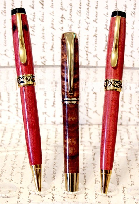

The pics below are TSW and Ren Wax.. The pink ivory set is one coat of TSW and the Curly Koa in the same pic is 2 coats.. the Bottom pic is also 2 coats... you can see a difference...
