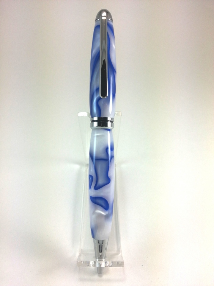

Here's one of my world-infamous lousy photos.

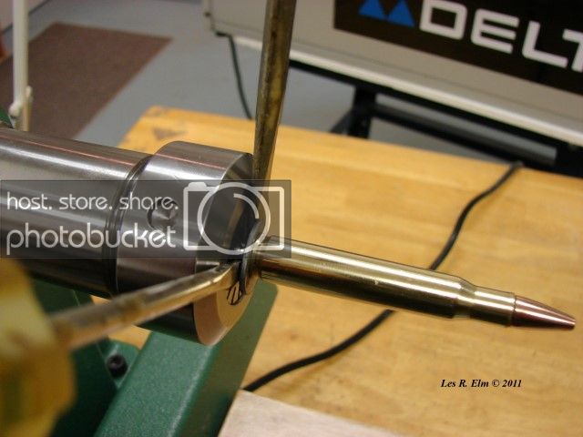

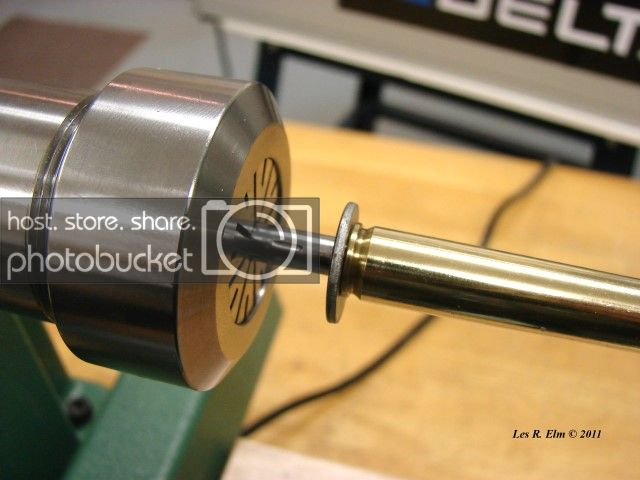

When I first got started with turning, I read about a trick that I used several times to remove transmissions.
Drill a 1/4" hole in a scrap of wood, and then cut a saw kerf from the edge of the block into the hole.
Place the block of wood LOOSELY in a bench vise with the hole facing up and with the saw kerf parallel to the faces of the vice jaws. Put two 1/4" washers over the hole, and then insert the transmission through the washers into the hole with the pen nib pointed up. Lower the transmission/pen body until the end of the turned blank is no more than about 1/8" inch above the washers, and then tighten the vise.
Then, insert a flat-blade screw driver between the two washers, and twist. This will force the washers apart, pressing the upper washer against the body of the pen, while the transmission remains firmly but safely locked into the wood-block 'collet'. It may be necessary to repeat the process, loosening the vise and dropping the transmission further into the collet until the pen body is finally pushed off the end of the transmission.

Thank you Les, Louie and Mike (yes Mike, I am roughing-up the tubes and allowing more than the recommended curing time). These are excellent ideas ( and photos). I am going to copy all to a pdf file and consult the next time it happens.
