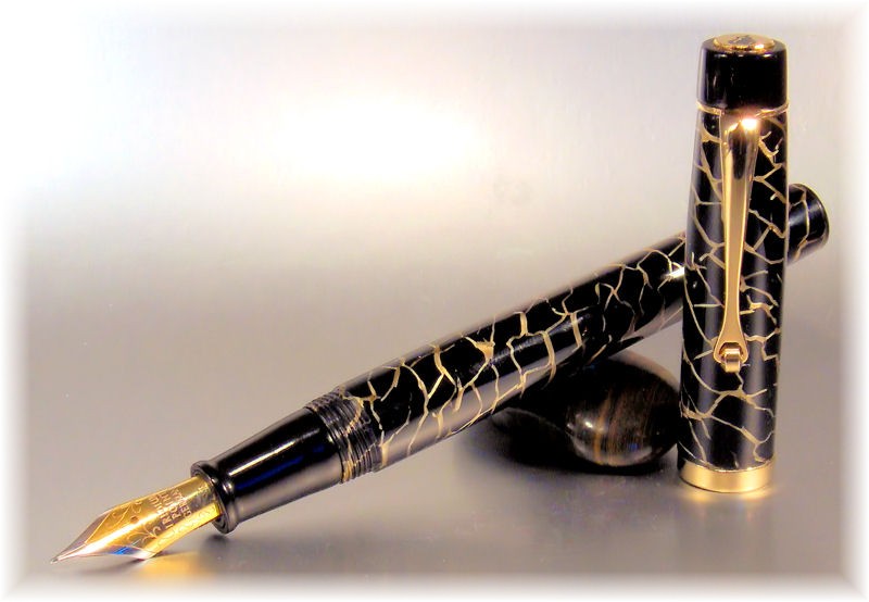

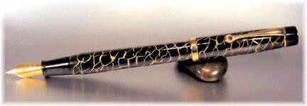

I'm snowed in today can't get out due to bad road conditions, so I thought I'd post a couple of photo's of a pen a customer wanted for Christmas delivery.
The pen is created from my own design and made from vintage celluloid in a Gold "Cracked Ice" pattern, Ebonite nib section and Gold plated roller style clip and trim.The customer required a fine two-tone steel nib made by JoWo.The pen is slighty larger than a Parker 51 in length and diameter.
Gold "Cracked Ice" is one of my favourite patterns and I'll probably make myself one of these pens to add to my own collection.
Constructive comments and questions always welcome.
Take care in the snow.
Bryan

Bryan, what a beautiful pen. The lines are so elegant and sleek with an understated statement. The fit and finish is excellent. Your customer should be well pleased.
Charles

How terrible for you. I'd love an excuse to spend the day in the workshop! Sadly, we only had a few more cm snow last night and the main routes are clear!
Oh, yeah, lovely pen, BTW. Where'd you source the blank?
...and it looks like you threaded the nib end of the blank? How? I've tried threading PR with a die, but it chips.

Thanks for the kind comments.
Ken,the Vintage celluloid came from a friend in the pen retail trade who had some lengths of celluloid rod he was looking to sell.
The triple start threads for the barrel and cap were screw cut on my Myford lathe, as was the single start threads for the nib section.
Vintage Celluloid is interesting material to work with, I have found you have to turn it to within a few thou above the finished dimension and let it sit for an hour or so as it expands slightly.Then take finishing cuts to size and finally screw cut the threads.
PR is in my opinion just too soft to try and cut with a die, and I doubt if you could screw cut threads on a lathe with any success,as every time I have tried, the theads just break up due to the weakness of the PR.
The Gold cracked ice celluloid does resemble a cactus finish although much easier to work with than cactus.You don't have to grow it, dry it out, cast it, and then turn and polish it. The celluloid just comes in rod lengths.
Snow was bad in Worcestershire yesterday a lot folks gridlocked on the M5 moterway for 7-8 hours,and Pershore had -19 degrees celcius overnight temperatures, that is cold for the UK this side of Christmas.
