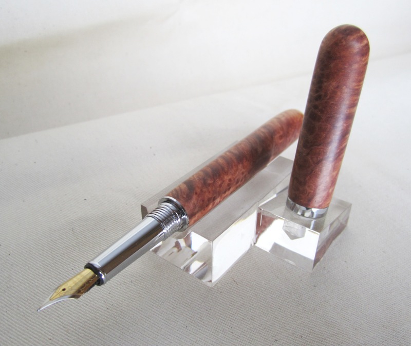

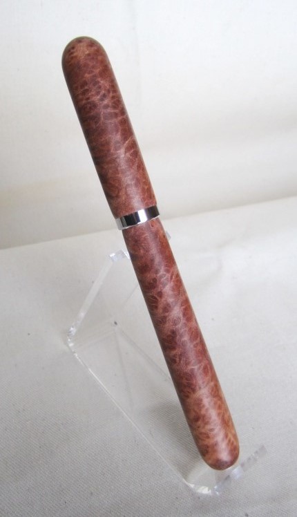

Got a set of pin chucks in from Rick Herrell yesterday sized for the Jr. Gent II series of kits and couldn't wait to put them to good use. Between last night and this morning I made my first closed end pen.
Wood is Stabilized Redwood Burl.
Finish is a satin CA finish I've been working on developing a process for - very warm in both looks and feel. Still have some work to do on tweaking it, but so far I'm happy with the results I've been getting.
Kit components used were from an Atrax kit.
In the cap portion beyond the tube, I coated the wood in epoxy to seal it and hopefully help keep the nib from drying out.

Alright, now that I'm the only one still awake in the house, I've got a few minutes to type, lol.
Here's how I achieved the satin finish. Still tweaking it - have done less than 10 pens with it so far - but so far I'm pretty happy with the results. Kinda feels weird to pretty much abandon the high gloss CA finish that I spent a lot of time getting just the right process down, but I really really like how warm this finish looks and feels. I'll still use the high gloss on occasion, but this satin finish will now be my go-to finish on pens. I like how it looks/feels and takes me a lot less time.
After turning, I sanded up to 600 grit, as I normally do before finishing. I applied 3 coats of thin CA. Sanded that back with 600 grit to even it out - with the lathe running and then lengthwise with the lathe off. Applied 2 coats of thin CA. Sanded with 600 grit to even it out - again, lathe both on and off. Applied two more coats of thin CA. Buffed that with some 0000 steel wool - and again, lathe both on and off. Then I gave the whole thing one quick swipe with a blue shop towel dampened with some lacquer thinner.
The lacquer thinner wipe down, which is a solvent that does soften CA (learned the hard way on that one some time ago...), was discovered by accident. Wasn't happy with one of my attempts in coming up with a process, so I grabbed the lacquer thinner to clear off the coat of wax I had applied before sanding down the finish and applying some more coats of CA. The wipe with lacquer thinner leveled it out and left it at the exact level of satin I was aiming for. There is a difference between what it looks like after the steel wool and after the lacquer thinner. It's not a huge difference, but it was noticeable to me.
