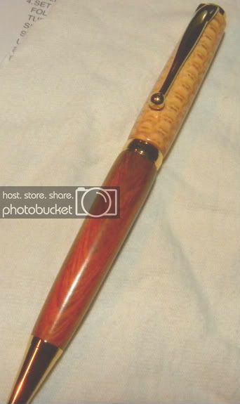

Here is a picture of the pen that I made. This is not my first corn cob pen and I made this one pretty much the way I have before. This is the first one that I made with a Slim. The bottom half is Iron wood.
I did not use Minwax wood hardener or vacuum.

This one looks a lot better than the poor photo. It is going downtown tomorrow and hopefully I will get my foot in the door for some future orders.
I will comment how they like it.
Nice looking pen! Hope you get some sales. When you said you completed this pen like the one's before did you use thin CA to fill in. If this worked why try to stabilize with minwax?
I filled and coated all the surfaces with CA. The reason that I wanted to use Minwax is I thought it might possibly strengthen the material. The exotic woods that I have purchased that were professionally stabilized seem to work well. I am just trying to offer a superior product.
