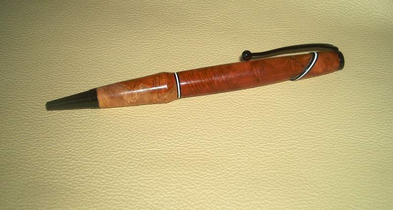

red mallee burl slimline

red mallee burl slim with pickguard material
guts
Aug 22, 2005
1,318
Fairchance Pa. USA.
glenn,i don't think i've ever seen a slimline like that before,very interesting design for sure,any info on how you're doing this with a slim line kit?? anyway nice work.
Ron Mc
Feb 2, 2005
2,138
USA.
Glenn,
I like this one more than the first one. That pickgaurd really does the trick! Well done.[:D]
RussFairfield
Passed Away 2011
In Memoriam
Feb 10, 2004
1,522
Post Falls, Idaho.
Now, THAT is a modified SlimLine. Great looking pen, and a good job on it.
Is the break in the pen a butt joint, or is there an overlap of the barrels?
Feb 18, 2004
4,130
Grosse Pointe Woods, mi, USA
Thee pen is done in two phases. First,cut all pieces and match the angle of the clip end sections. Then you finish to completion, including polishing, the two sections as usual leaving the larger section at the cap end off to be completed later. Then you glue up the clip end and finish that section.
