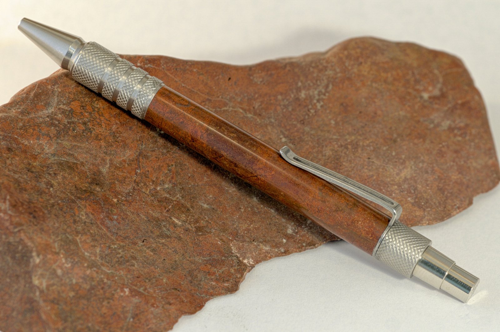

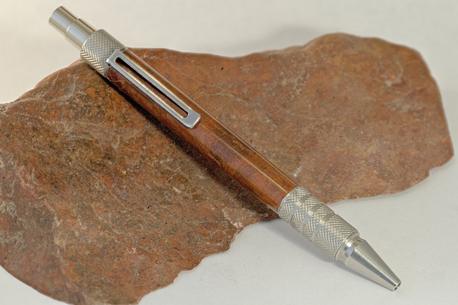

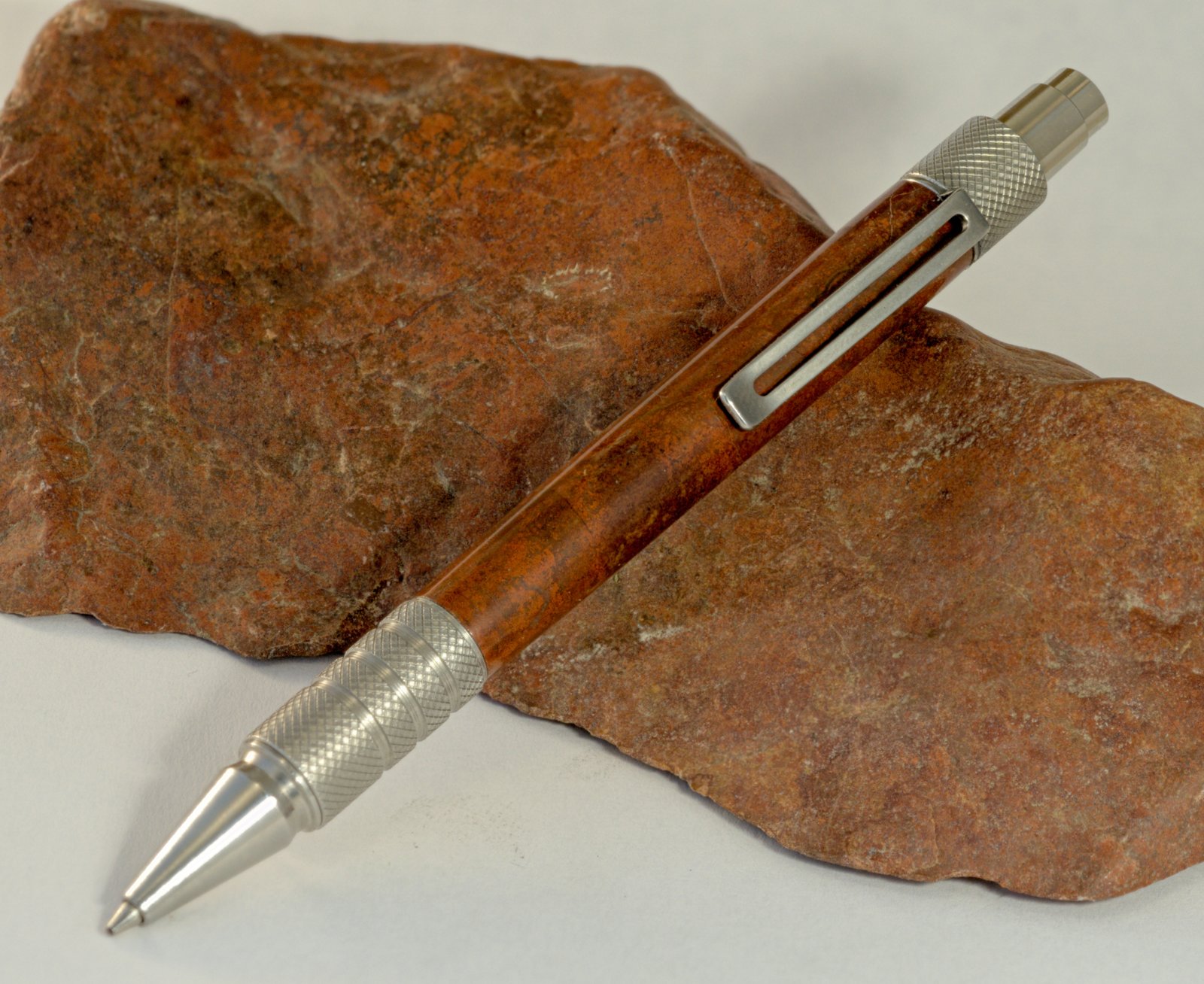

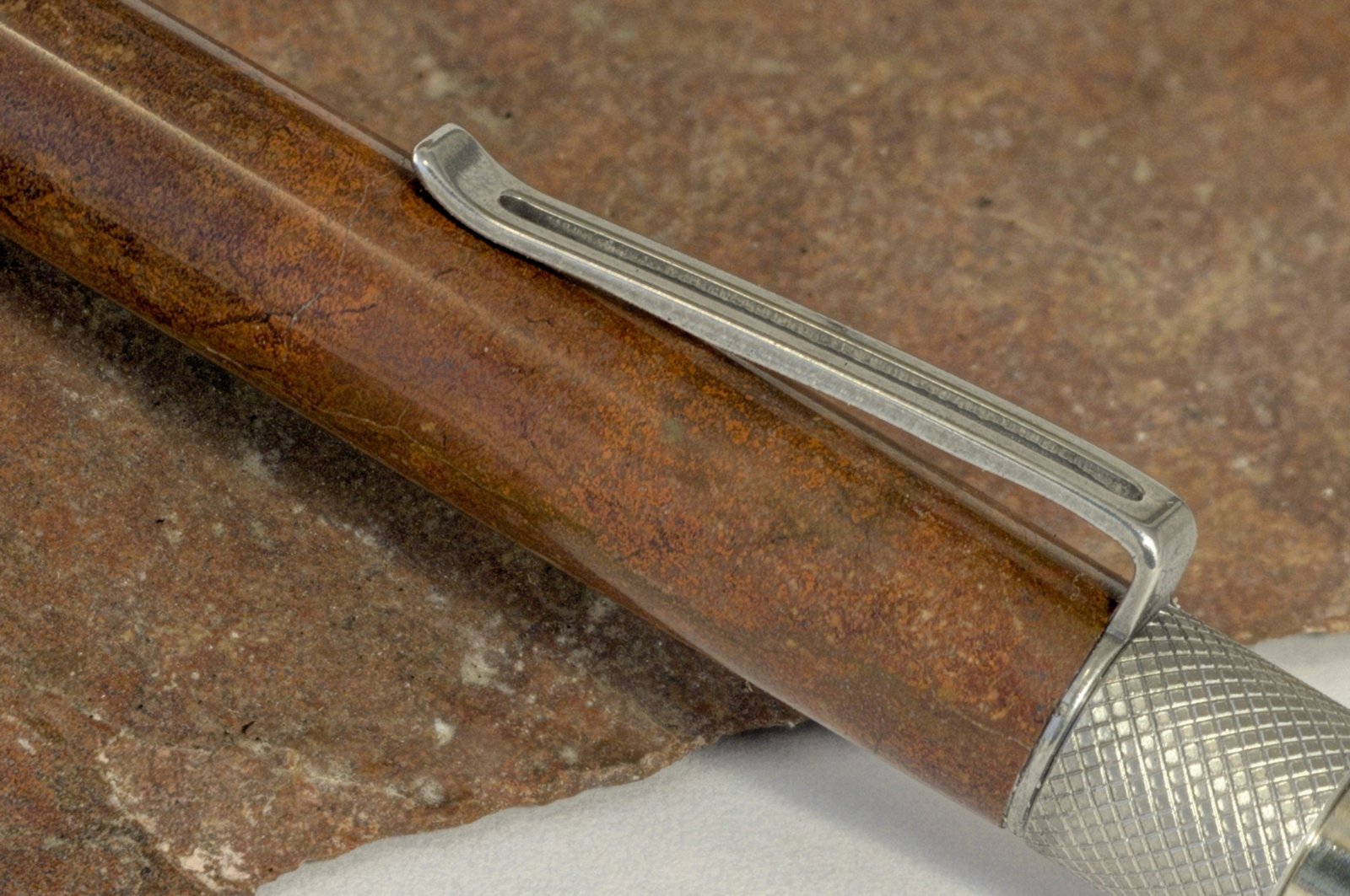

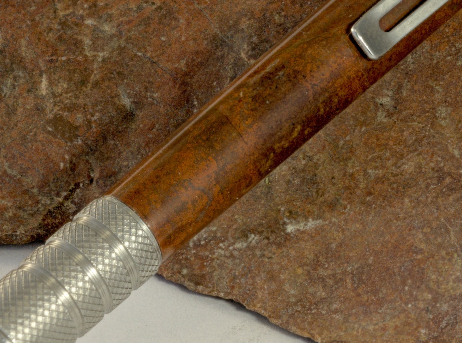

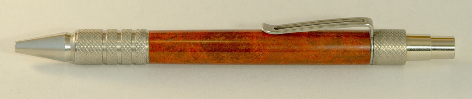

From a distance, it's just a red pen . . . but when you really look at it, it has depth and has so much variation! This red jasper is noticeably harder than the other jaspers that I work.
Thanks for looking!

Good stuff! I've noticed your other work and am really impressed. I'm sure it's a LOT different than turning other "stone" (aka Tru-Stone, etc). Care to share your methods? Suspect it's not on a wood lathe.
dcameraman
Apr 10, 2012
48
Trail, OR
It is VERY different from turning Tru-Stone. The stone I'm using is harder than knife steel! One if the tests I use to determine hardness is a scratch test. First I use a penny, which usually leaves a streak of copper on the stone. Then I go to my pocket knife, which quite often leaves some metal on the stone!
I don't mind telling the general aspects . . . but I don't want to get into 'trade secrets'!
Diamond slab saw to get 1" x 1" x 4-7" pen blanks.
Diamond drills for the hole.
Diamond grinding wheels to make it round and polish it and square the ends.
It has taken me many years and trials and errors to get to the process I use now. But they sure are beautiful!
