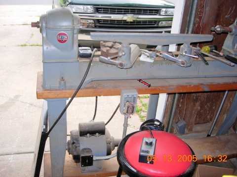

I just bought a lathe, which I am in the process of making useable, ie greasing/oiling and a switch. I just need a starter set. Here is my lathe.[:D]
BTW, I am going to install a heavy duty switch, not that vsr thing in the picture. Thanks to you folks.[:I]

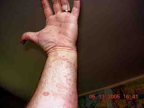

Oh I almost forgot, have any of you had a bad reaction to bolivian rosewood? My hands are getting unuseable, they are so covered with poison ivy-like bumps. Now they are starting to hurt, not just itch. Any suggestions? Aside from the obvious: don't work with the stuff.
woodwish
Jan 29, 2004
966
Lynn Haven, Florida, USA.
I've seen the same reaction to cocabola, which is somehow related to poison ivy, but have no suggestions other than yours. You may try some of those blue latex gloves that some of the fancier mechanics use to keep the dust off your hands but are fine enough to not be dangerous like cloth gloves would be. Be sure to use a good DC system and respirator, inflamed hands are nothing compared to inflamed lungs and throat!

[B)]This may be my last post for a while. It is really uncomfortable to type. I read that drying your own blanks in wet sawdust can create your own spalt. Is that true? If so, then how much saw dust, does it have to come from spalted sawdust? I really like the look of spalted pens. I have a bunch of curly spalted oak, which I'm going to formally introduce you all in a bit, but I would love to learn how to make my own. I planned to mix regular sawdust with spalted and soak bowl blank size wood. But for how long? How much water do I put in? I have some nice 6" slabs of hickory I got in today, that I would like to spalt. Well, I'm falling asleep on the keyboard again. I hope to hear from y'all soon, but I may not be responding very quickly. I'll be back!![B)]
<br />
This is before it got bad. Good Ol' contact dermatitis. Lungs are feeling a slight bit better.

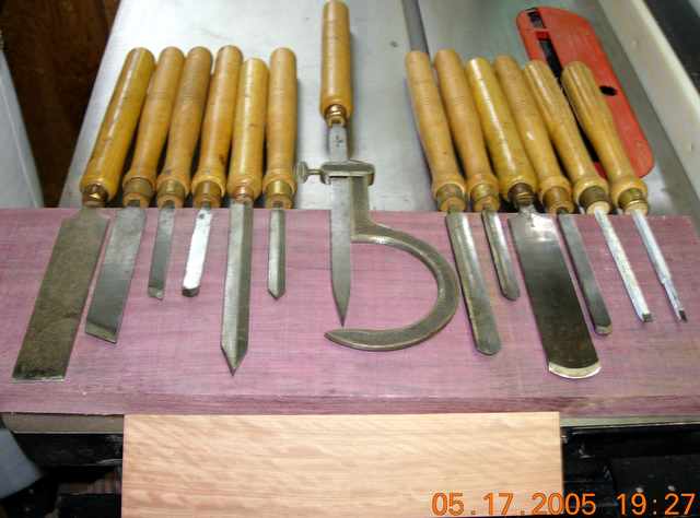

I may have led you kind folks astray. I have a lathe, I want a starter set that doesn't include one. I need the mandrel and drill apparatus and whatever else, but not the lathe. I can't wait to get this one up and running. I do have a short tool rest also.

I suffer the same reaction as you do. Beleive me I wish mine was that light. I have bumps like yours from my forearms down to my waste and on my legs. The arm pits are the worst area to have it besides an obvious location. [;)] (Yeah, I've had it there too.[:(!]) All this from Walnut of all woods. You need to clean up every little bit of dust from that rosewood or you'll regret it. I've broken out 3 times since I stopped turning walnut just from loose dust in my shop. I keep my shop fairly clean as well and have cleaned the area well twice. Lacewood does the same thing to me. I won't even think about paduak or rosewood. I don't have a death wish.[:0]
