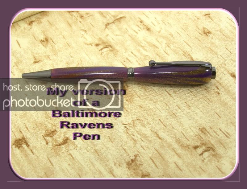

Nice pen, and nice design. I like the upper barrel size and shape. Did you have to do any modification on the clip to make fit?

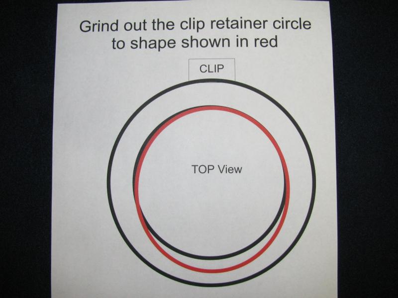

This could help.
For years, I have made a design on the slimline that "can't work" because the clip can't sit right.
Well, below is the secret. Take your dremel and put a grinding bit on it, grind the back (away from the clip end) out a bit and, voila!! you can get a half inch top and the clip will still hold the pen in your pocket, using the standard "fancy" clip. Follow the "Red line" path on the picture!! (old dog learned new trick)
Now, just buy all your slimlines from exotics:wink::wink:, they will work.:biggrin::biggrin:

That is a great looking pen. I really like the shape of it, very nice. Is it black titanium/chrome?

Yes its Black titanium/chrome......
