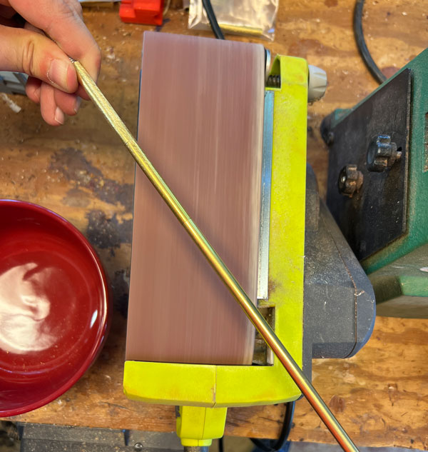

I know lots of people don't scuff their brass tubes.
I do because it seems to me the only times I had problems with tubes coming out was when I didn't scuff them before gluing. YMMV.
However, when I buy 300 kits and have 600 brass tubes, I really don't want to scuff them all by hand with sandpaper.
Here's my new and improved process.
I use a long, threaded rod from HD to hold 9 or 10 tubes and use my belt sander upside down.
Holding the rod at 45 degrees, the entire sleeve of tubes rotate and scuff in about 5 seconds.
Loading the tubes onto the rod was taking longer than I wanted. Then I discovered the tiny earth magnets I use to hold bushings on my lathe create an easy way to hold the rod upright while leaving both hands free to load tubes onto it.
Thanks for looking
- Cullen

Cool suggestion Cullen! I don't work in the quantities you do, but I do see scuffing tubes as a tedious task. Simply loading a mandrel with the tubes I am using at this moment, and using my belt sander to scuff them will make the task go faster. Thanks for sharing

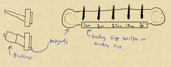

Dave:
Thanks so much for the kind words. I haven't designed any storage for bushings but that's only because I only ever use 7mm bushings... so I keep them stuck on a magnet on my lathe.
Obviously, many turners like yourself have lots of sizes to work with. What would be the design criteria? Would ease of accessibility be key? If I were to think through this quickly, the solution might look like a "hat rack" I'd keep stuck to my lathe with magnets so I could reach them quickly.

I saw a post from a fellow, Del Hilburn, on the Woodnet.net forums of a printed system he came up with a couple of years ago. It was essentially little drawers, kind of based on the PSI bushing storage rack. I thought it was a cool approach. Here is a link: WoodNet Bushing Storage. - Dave
