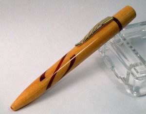

Short anwser is it depends. For me, when being sure that things align perfectly with the tubes, I turn round, drill on the lathe, then use the holes to re-mount the blank and re-turn it round. Now the hole is pergectly centered. Next step is segment, for example a celtic knot done this way will be right on. Re-chase the hole to drill out any segments, then glue in the blanks.
This is the process I came up with when I wanted to go for perfection, and it worked well on this pen. I would only go to this much trouble when I wanted dead on pattern alignment. On this pen I wanted all the tops and bottoms of the feathers to be even.
