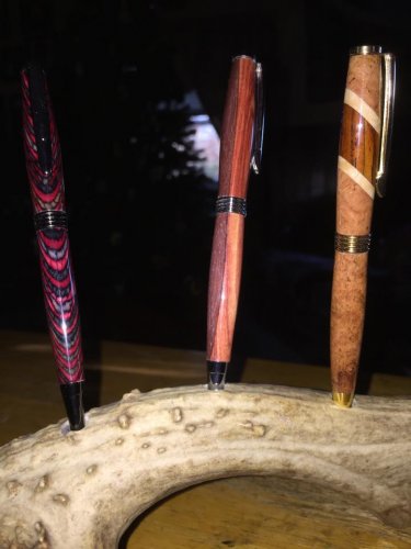

Ok well i was going to attach a pic of a few pens i just finished. But i seem to be having a hard time figuring out how to do that at the moment. anyway, I am making umm funline maybe? pens at the moment. and selling them for $20.
