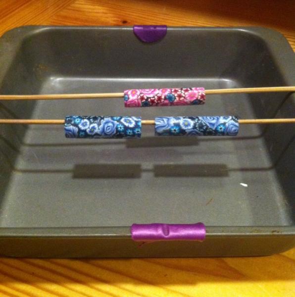

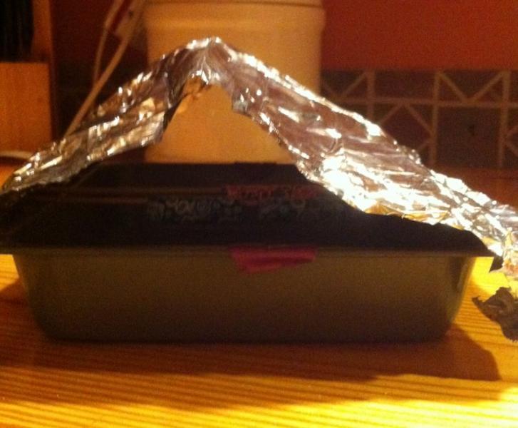

Hmmm, I've never tried any of the ways you mentioned.
Try this and see what happens ...
wrap the tube with the clay (a little thicker than bushing size) ... I was gonna try explaining how I cook mine, but pictures say a thousand words. :biggrin: I put them on wood skewers and set them on top of the pan, then put the foil "tent". I put the pan in the center of the oven and bake. So far (knock on wood) I've never had mushy or soft tubes.
I'm no expert on any of this, just saying how I do mine.:)

I'll give that a shot. It's pretty much how I've done mine with the foil pans, but I didn't leave the tin foil tent open like that.
Thanks
