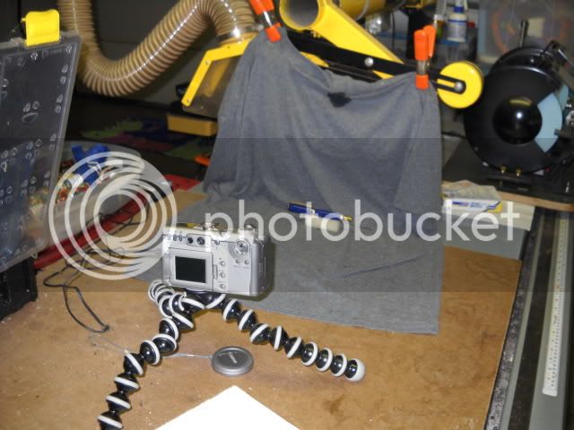

Try this:
  1. Use a darker gray background (like a dark gray sweatshirt or T-shirt). This is a "poor man's" attempt to get accurate white balance and color representation without actually setting white balance.
  2. Turn flash off and ensure your camera is in "close-up" or macro mode if available (usually indicated by "tulip" icon)
  3. Use a tripod or set on a stack of wood/books if no tripod -- anything to get your subject in the focus field of your camera.
  4. Focus the subject if auto-focus not available on your camera
  5. Use a remote or timer to actually take the shot to minimize any hand shake (doesn't matter how steady your hand may be -- you can't beat hands-off operation)
  6. Use photo editing software to crop the photo to show only your subject (I use Picasa -- free software from Google)
I have no talent as a photographer, but I follow these steps using an older model 3 megapixel Canon G3 under flourescent lights in the garage. Artistic? Not at all, but color is accurate and I'm happy with the detail.
This is my pen photo set-up:

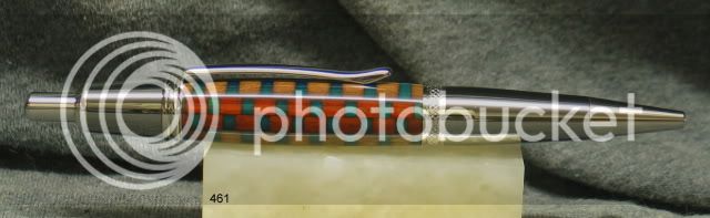

...and a photo using this setup:
