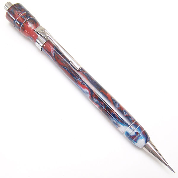

Here's the one I was excited about. I got that swirl in a pipe mold, no stick swirling.
A minor thing I'm sure, but a big step for me. :biggrin:

Don (DuroShark), I really like the colors that came through as swirls - they are great! Any comments on how you accomplished it?

In my 3/4" pipe mold I poured the 3 colors alternaating an ounce at a time or so.
That combined with letting tje cups with the three colors sit on the us cleaner for 5 minutes gave me the great swirl with good definition.
I've been able to repeat the results with more subtle colors so I'm happy.

Thanks for the info - I am learning this casting stuff and everyone does it just a bit different. I think I'll go try some more tonight!
