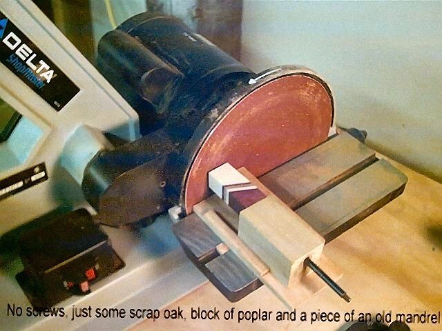

I was wondering what others here are using as a jig on their disc sander for squaring the tubes to the pen blank end. I'm aware of the PSI jig, but it looks kind of flimsy to me. This photo is one I found at the penturners Y
ahoo group. I guess you could just make some sleeves to be used with the larger tubes. I don't like using a pen mill on some burls and would like to do them on the disc sander. Any other suggestions would be appreciated.

Gary, the jig in your pic will cost little to make and try. Then you can decide if you really like it. By the way, I have found that most 1/4" bolts are actually a little smaller in diameter and are a snug fit in a 7mm tube. If you don't have a mandrel that you want to cut up, that is an option.

I use the disk sander and a jig similar to the one you posted from yahoo. I found when I started making larger pens, the pen mill was of no use. I just turned a sleeve from scrap to fit the ID of the different size tube I use on the larger kits. I drill the sleeve 1/4...no use to waste a brass tube. I find the disk sander and jig a much better tool for squaring pens than the pen mill.

Gary the PSI jig is not flimsy at all, it's all that I use any more. I've made bushings for it so that I can square up all of my blanks with it. You could also make one by getting a couple pieces of al. angle and a piect of drill rod or something like that in 1/4".

Thanks Wayne, I had hoped to find someone that had actually used it. What material did you use for the bushings you made? Did you just drill some stock and then turn them to fit the various tube sizes?
