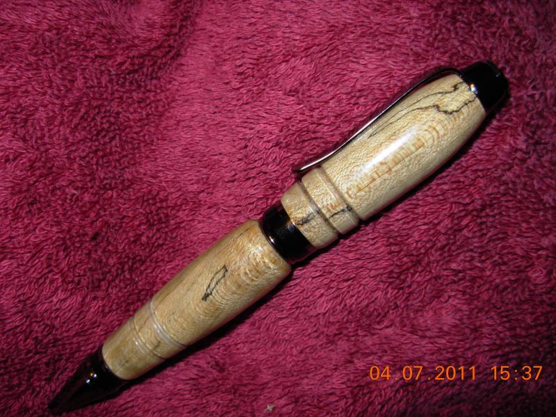

What your talking about, I actually like to over turn (roughly the same dimension as the upper barrel at the center band), and then round down into the coupler ring. I just like the way it looks like that. Below is an example where I took it a bit to the extreme, but I liked the final product so left it as is.
