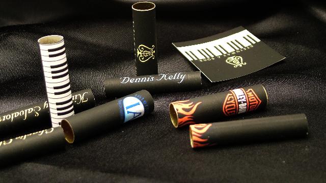

I believe you are referring to the pen I posted:
My process:
- Powder coated the tubes black.
- Made a templete to cut out the label (
:wink:)
- Using Word I printed the label on Avery 8xxx (I'll fill in the xxx when I get home) labels.
- Used Needle point protectors purchased at Walmart as reusable end plugs:
- Used BBs in the tubes to help hold them down
- Used center-drilled pennies and toothpicks to hold the tube in one of Gadgets silicone 3/4" x ??? molds
- Used 3 drops/oz of mekp in clear resin.
- Cast in a pressure pot under 20 pounds of pressure.

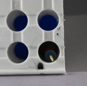

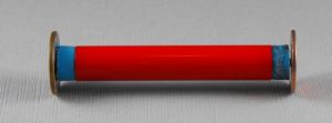

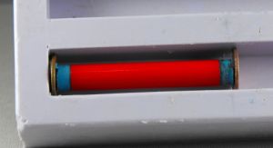

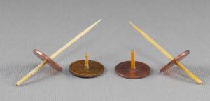

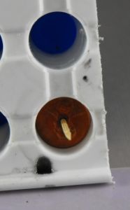

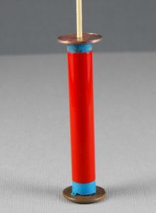

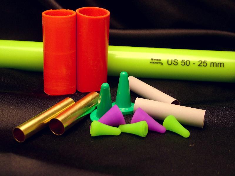

As Promised:
Labels: Avery 8253
Pictures of the Pennies:
Pennies with center holes drilled in them and toothpicks:
A tube with Needle protectors as plugs and pennies as an offset for use in a silicone tray:
Tube with penny offsets in a silicone mold:
Tube with penny/toothpick offsets for ice cube tray:
Take the top penny off. Place the bottom penny, tube, plugs and top toothpick into the ice cube tray. Pour the resin around the tube:
Slide the top penny over the protruding toothpick to keep the tube centered in the ice cube tray:
The needle protectors already have holes in the center of them and if you are careful in the removal, reusable.
Hope this helps and starts you down the path. Once you get the process down the possibilities are limitless:

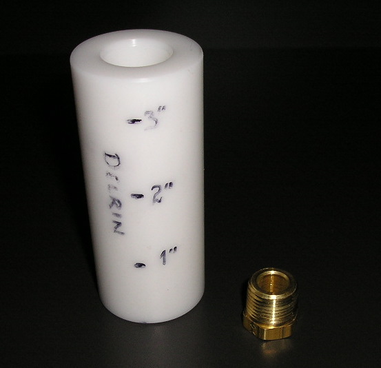

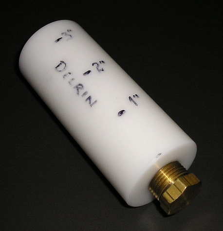

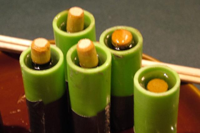

wood-of-1kind
Jul 10, 2005
4,115
Toronto, ON, Canada
But how do you stop the BOTTOM tube from moving??
I use delrin casting pots and by inserting a dowel through a wooden circle manage to "centre" the label casting as it sets in my pressure pot. Using these pots is very cost effective since very little of the resin goes to waste. The round casting shape makes it easier to turn as opposed to a "square" casting.

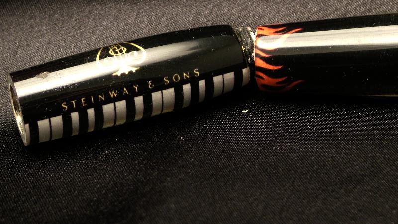

Here's a couple of rejects I was testing things on. (copyright violations :tongue:)
ps, thanks for taking the time to explain some of this, Squirrel.
I really do appreciate it.

Tonights work in progress
forgot to bring the dowels that I tapered to fit into the tops of the tubes :eek:
Remembered that just as I started to pour. (I cut larger ones for the tops
of the Jr Gents)
We'll see ..

In the craft section. Look for knitting yarn. They will be close.
I must not have decent WalMarts here, they didn't have them either.
I did find them at Joann Fabrics though. I got a few different sizes for the
different kits. The big green ones in the back are a good base for all tubes
and the resin didn't leak inside. :biggrin:
The medium ones (purple) are good for the tops of gents & barons. If you
spray them with release, you can just pour the resin over the top of them
and not worry about it. The bright green ones are good for cigars and the
bottoms of the gents and barons, sierras etc.
Wallys would definitely be cheaper ..
